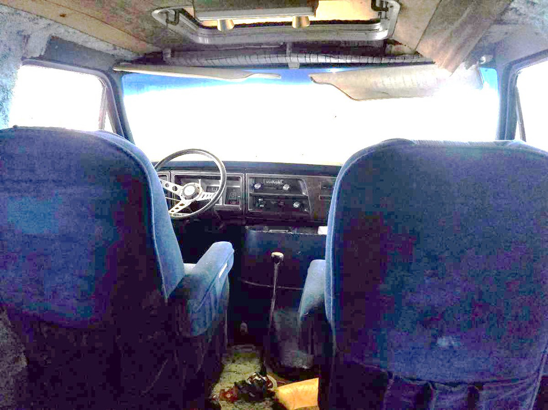

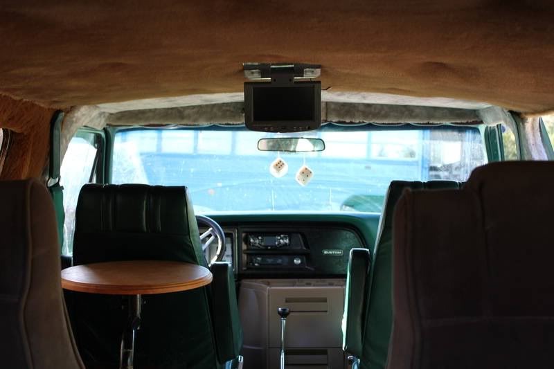

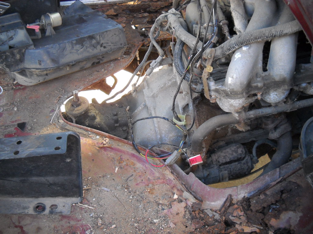

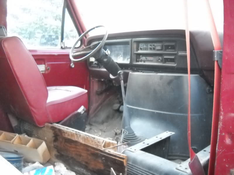

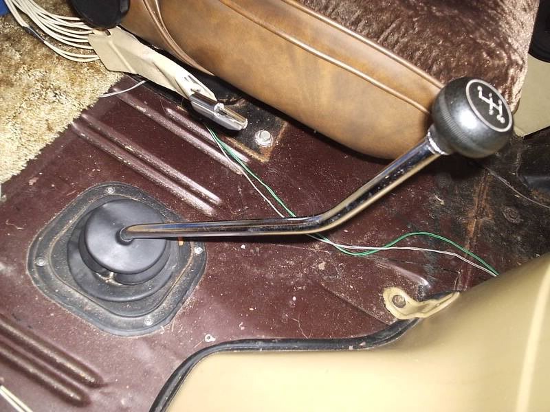

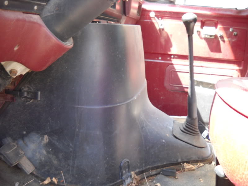

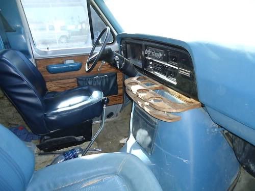

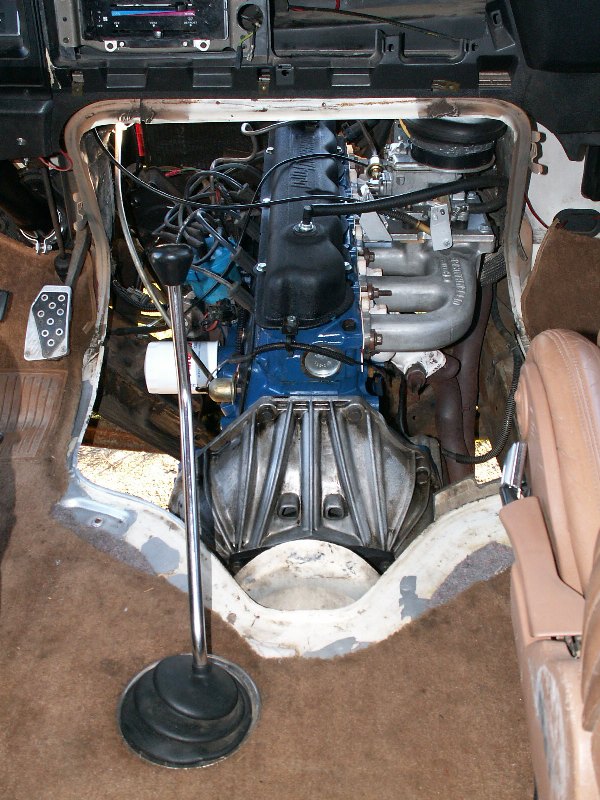

The last year for the manual transmissions was 89 or 90. They offered 3spd's, 4spd's and later ones 5spd's.
The 4spd's and 5spd's were both floor shift. The most common type of 4spd's that I have seen were the old 3spd with OD. Where the shifters were of external linkage variety ( like the 3 spd's and old car 4pd's ) and mounted on the tail shaft housing. The shifter comes thru the floor by the passenger seat.
I've only seen a couple that had NP435's. And have no clue if they were a factory option or swapped in.
The NP435's and the 5spd's had the shifter's come thru the back of the dog house.
A very small percentage of the Econoline's built were manual transmissions. And most of those were in the E100/E150's.
I plan on swapping a NP435/NP205 combo into my 89 E350. I've got all the parts to do it. I'm just trying to get some other projects done first.
Here's the pics I've got.
4spd's:
Here's one of a NP435 or a T-18/T19 ( don't remember which ) :
And the 5 spd:
These are the pics of the donor van I bought a few years back for my swap parts. It was a 5spd too:
And some pedal shots:

Wow, thank you very much for those pictures! Like I said, I had never seen one before in person (or even online), so that definitely answered my question.
