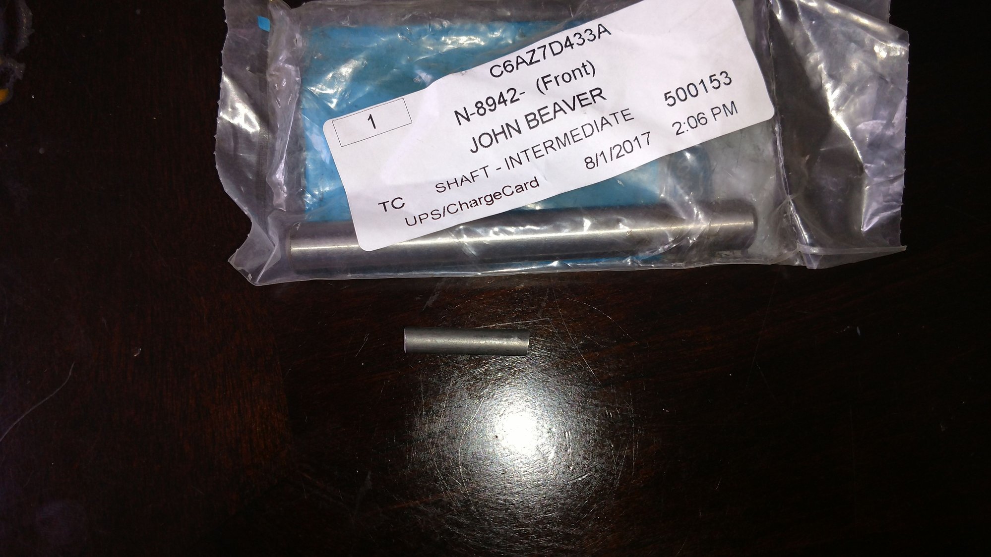

I'm thinking it might be the 7D433 in the pic below. Part number C6AZ7D433A. Intermediate band actuating lever shaft.
So I cannot find this part available anywhere. A couple of the websites I visited say it's no longer manufactured. Am I going to have to scrap my tranny over this?

I'm thinking it might be the 7D433 in the pic below. Part number C6AZ-7D433-A .. Intermediate Band Actuating Lever Shaft
No, because here are 4 of the puppies:
C6AZ-7D433-A =
MILLER OBSOLETE PARTS in Binghamton NY has 1 = 607-722-5371.
GREEN SALES CO. in Cincinnati OH has 3 = 800-543-4959.

So I don't think that's that right part.
the bottom shaft is what I found in the pan (obviously). I think I will just have to take out the valve body assembly and start poking around to see what I can find.

If it is that piece by the red box it looks like Ford only serviced it in a complete valve body. Note the piece to the left of the 7D227. Are you sure there were no other issues other than what you mentioned?
