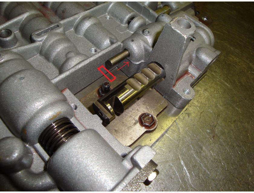

So taking the cable out was a breeze. It popped right out this time. I think I know the problem too, the cable slipped right out of the end that attaches to the tranny. While I was down there, I decided to replace the tranny filter and gasket. I noticed this:
in the bottom of the transmission pan. I looked at the underside of the transmission and could not figure out where this came from. Any ideas? I've got a few days while I wait for the filter, gasket, and speedo cable to arrive.

I don't recognize it yet. What diameter is it?

About 1/4". It is also a little over an inch long and clearly broke because the one side is not even.
It's a bit difficult to see, but it has a granulated end that is 2 different colors in the second picture.

I've been looking around the internet. Could it be the rod piece next to the red box? Or the band strut/anchor? I haven't had the chance to take the valve body out to see where that piece came from. I'm hoping to figure out what it is and order the part soon so I can just take care of the whole transmission at once. Then I get to put in a new wiring harness...

I'm thinking it might be the 7D433 in the pic below. Part number C6AZ7D433A. Intermediate band actuating lever shaft.
I will look into that. Any idea how to see if it is? Will I have to drop the whole tranny out or can I get to it by removing the valve body assembly? It's hard for me to tell where the part even belongs from the picture.

Here is another pic of it maybe. If it is the 7D433 I don't see how 2nd gear was working. Is it possible that jolting you experienced was actually the tranny trying to hit 2nd then dropping to 1st?
Its very possible. That could also explain why it seems to stick in gear before upshifting. I never paid enough attention to tell if it was skipping straight to third. Looks like I'm going to have to drop the tranny to get to this.
