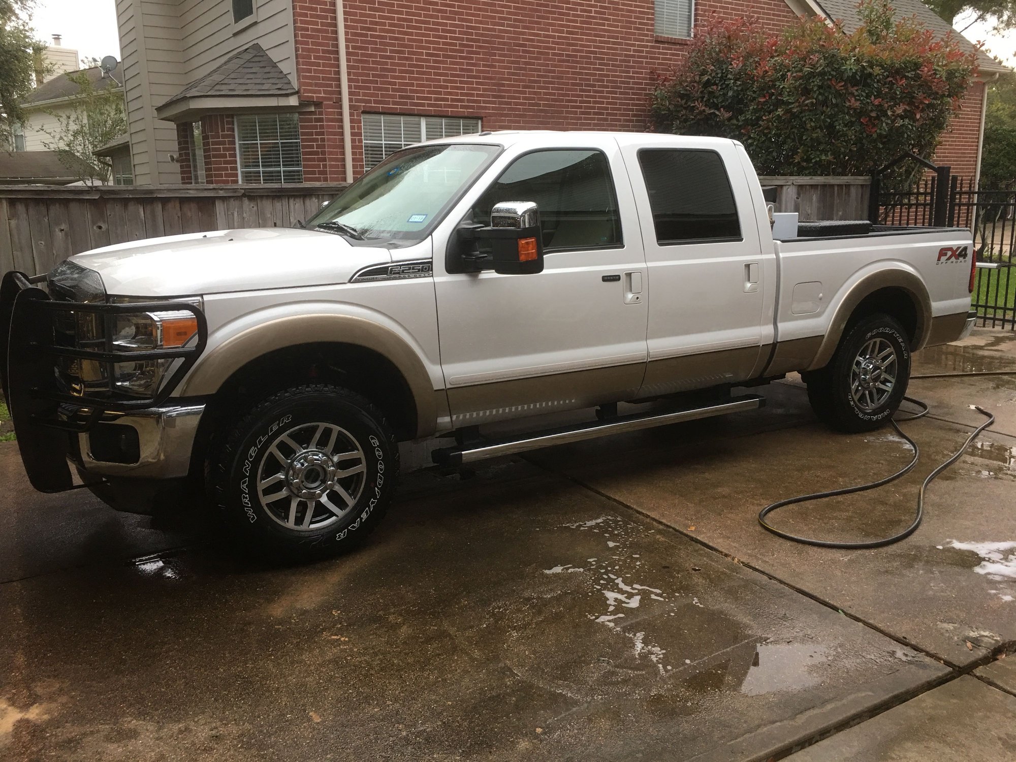

I have a set of the 2017 18" wheels on my truck. No issues putting them on. Just have your TPMS switched over to the new wheels and your good to go!
