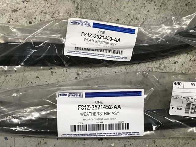

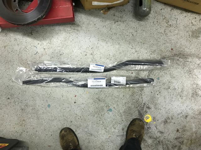

Sorry about being slow on this little job.
Here are the part numbers for the front weather strips right and left.
F81Z-2521453-AA
F81Z-2521452-AA
I am not sure what one is right and left. But they only go in one way.
Not that hard to pop them out and back in.
If you don't replace then be sure to remove the old ones and give them
a scrubbing with a finger nail brush to remove any grit trapped in the felt.
