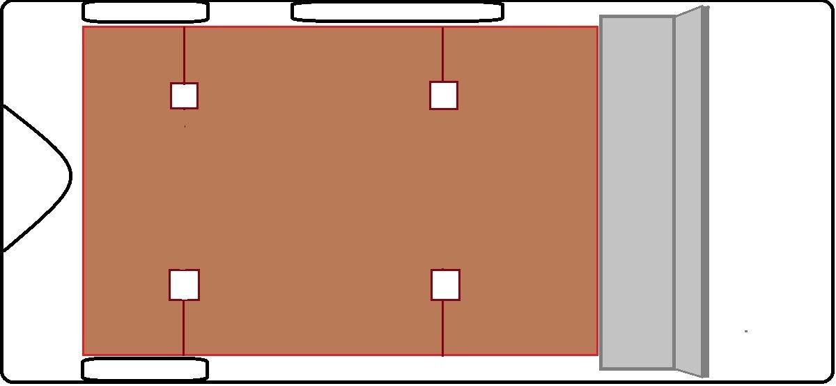

I have never cut my own for my vans but both are conversion vans and the carpets in both were cut, fit, and glued in place. I too need to replace mine. When I get to it I will pull the old out and use it for a pattern.
In the mean time though I have thought about just buying a area rug and cutting it to loose lay on top of the old carpet and some new mats for the front to lap over the area rug. My carpet is still good around the edges where there is no traffic. Just trim it around the seat pedestals and use some of the cold seam carpet tape on the back side. If it fits right one could loosen the floor/door opening moldings, get the new carpet under them and reinstall the moldings to hold it in place where you enter and exit so it would get caught on your feet. You wouldn't have to worry about the other edges because no one will be walking on them. If you have a back seat like my van, just let it lay under the edge of the seat.
