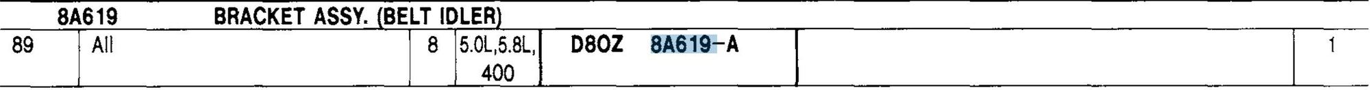

Hi... I need your help.
i´m from Argentina. I bought a Ford V8 302 (Ranger 80 pickup) disarmed. I´ve one bracket that i don´t know what is from.
It have a code number: DOAE 8A619-E
May be it´s from AC conditionar or from steering pump. I has looking in internet, but i couldnt found it.
Thanks for your help

I believe it is the power steering bracket for a 302

It isn't the power steering bracket as those are 3C511 and 3A732, as shown here: Power Steering Brackets - ???Gary's Garagemahal.
Instead, it looks to be an idler pulley bracket, and here's what I found in the catalog:

Thanks, but..... The catalog say the bracket was used in 1989 only, as there is no "/" behind the "89". And it says it was used on the 400 engine, which was last used in 1983. So, that piece is very confusing and probably quite wrong.
But, at least we know what it is, just not exactly what it was used on.
