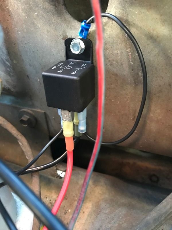

I swapped over to the HEI distributor when I got rid of my feedback carb and computer. Here's the relay to send 12v to the coil when the key is on.
30 is (+) in from my battery, 87 is (+) out through the relay to the coil, 85 is coming back up to the screw to ground it, and 86 is the 12V that is hot when the key is on to trigger the 30-87 circuit.
Then you find a ported vacuum source that's pulling zero at idle and only pulls vacuum when you put your foot on the gas. I'll take a picture in a minute to show you where I'm getting mine.
