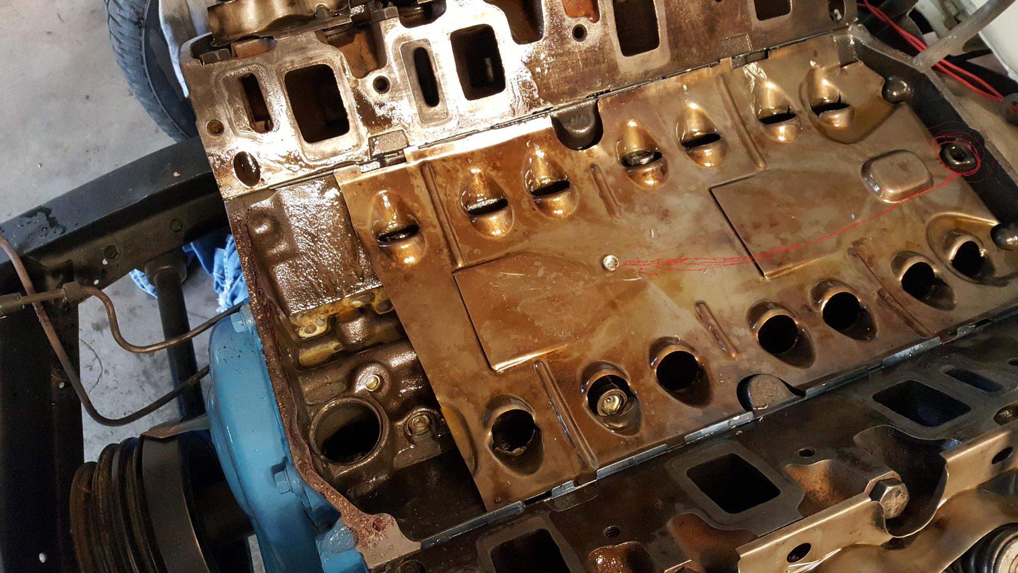

I recently purchased a low mileage rebuilt 390.
I put on an eidelbrock intake and when I started it it I had two wires crossed.
It fired up right away but it also had on miss fire about every 2 to 3 cyles. I shut it off. found the problem and it fired up again, and the the thermastat housing started leaking water.
end result I removed the intake and found the end oil plug had popped up from the back of the oil journal.
Question is....
How do I reset the plug? i have placed it in the opening but how much pressure do I use to seat it?
Would the missfire have popped it on to the windage tray?
picture as where i found the plug.
Thanks for all and any help.
Oh yea. The 390 is in a work in progress 54 f100.

Does this oil plug (if I have named it right), does it keep the oil pressure to direct the oil to the cam bearing?

Whatever you do, get a new plug - it should come in a "expansion plug" kit - I think this has it in it:
Amazon Amazon
Using a small socket, or something similar that just barely fits inside the hole in the block, hammer it home.
Some people might suggest using a sealer on it - wait for more answers.
The misfire wouldn't have done this - it was loose to begin with and oil pressure pushed it out.
