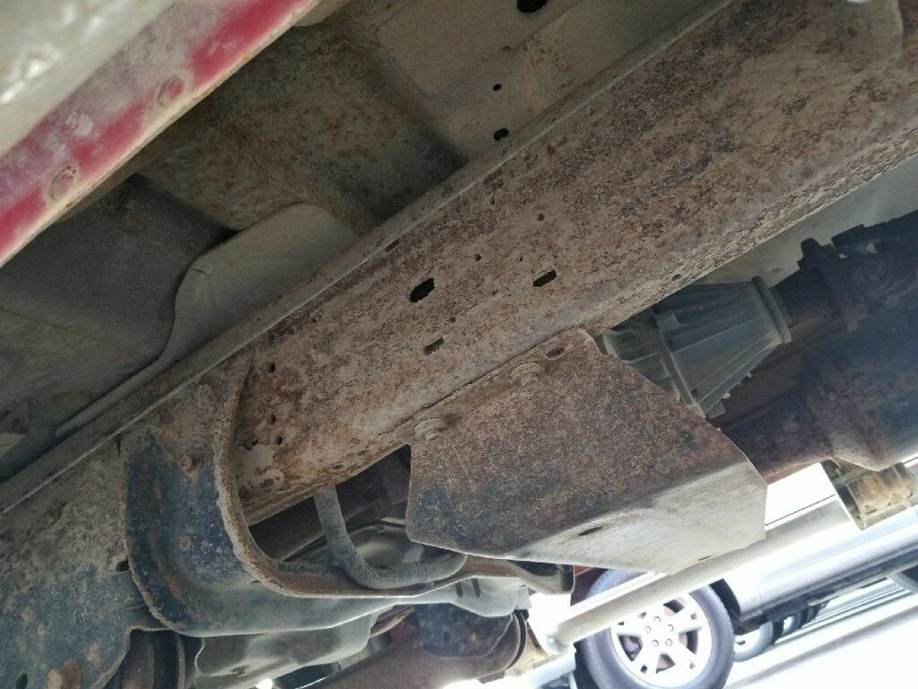

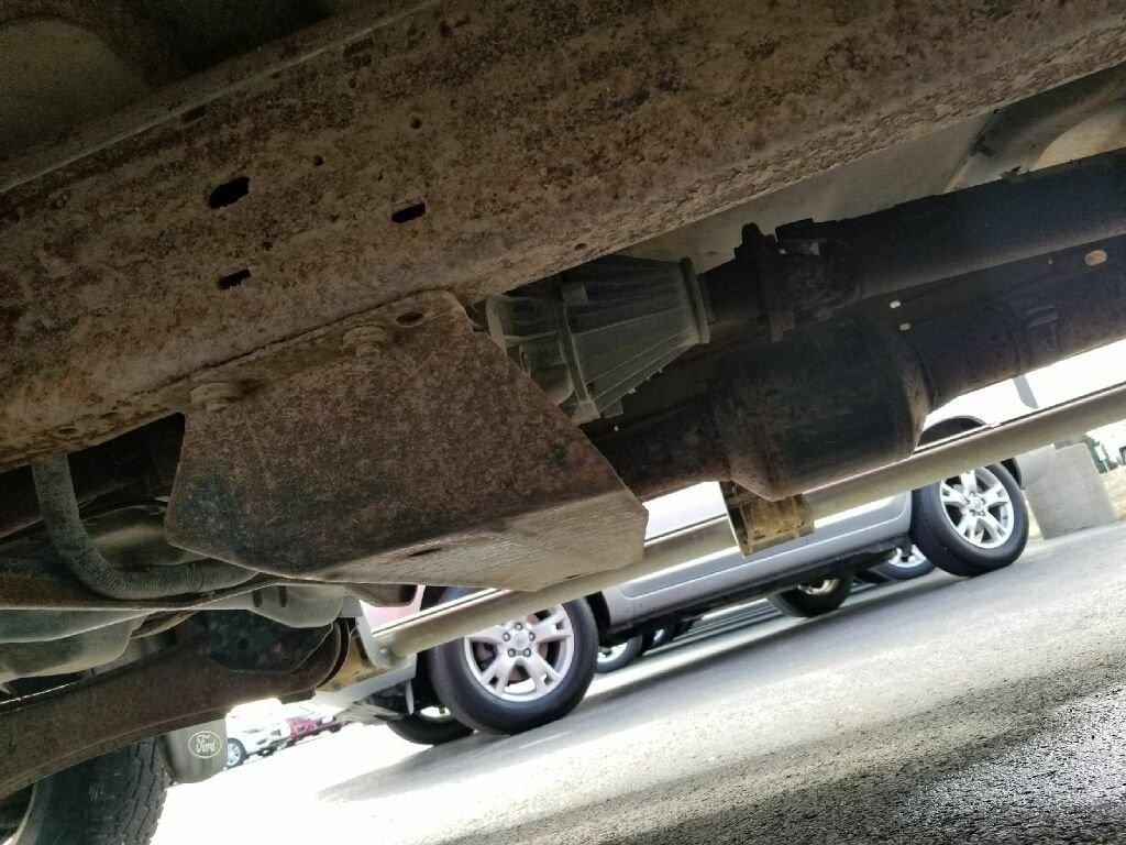

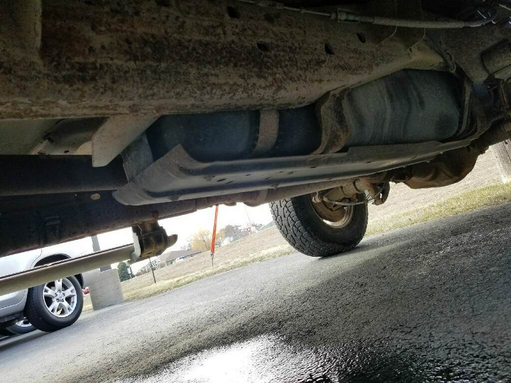

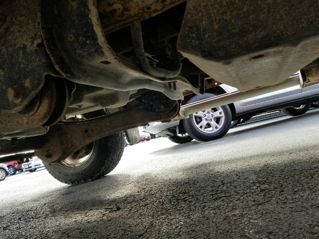

what do you think of this rust? 05 60k miles
I'm the type of guy that would spray used motor oil on everything, maybe fluid film is good but something is better than nothing. Been dipping steel tools in used motor oil for years, It's recycling! But anyway do you consider this deep surface rust or real problem rust?
That's like brand new compared to my '06 with 60K miles, lol. See that skid plate under the transfer case in the first picture? I had to replace mine - the original was rusted so badly I could fold it in half just using my hands.

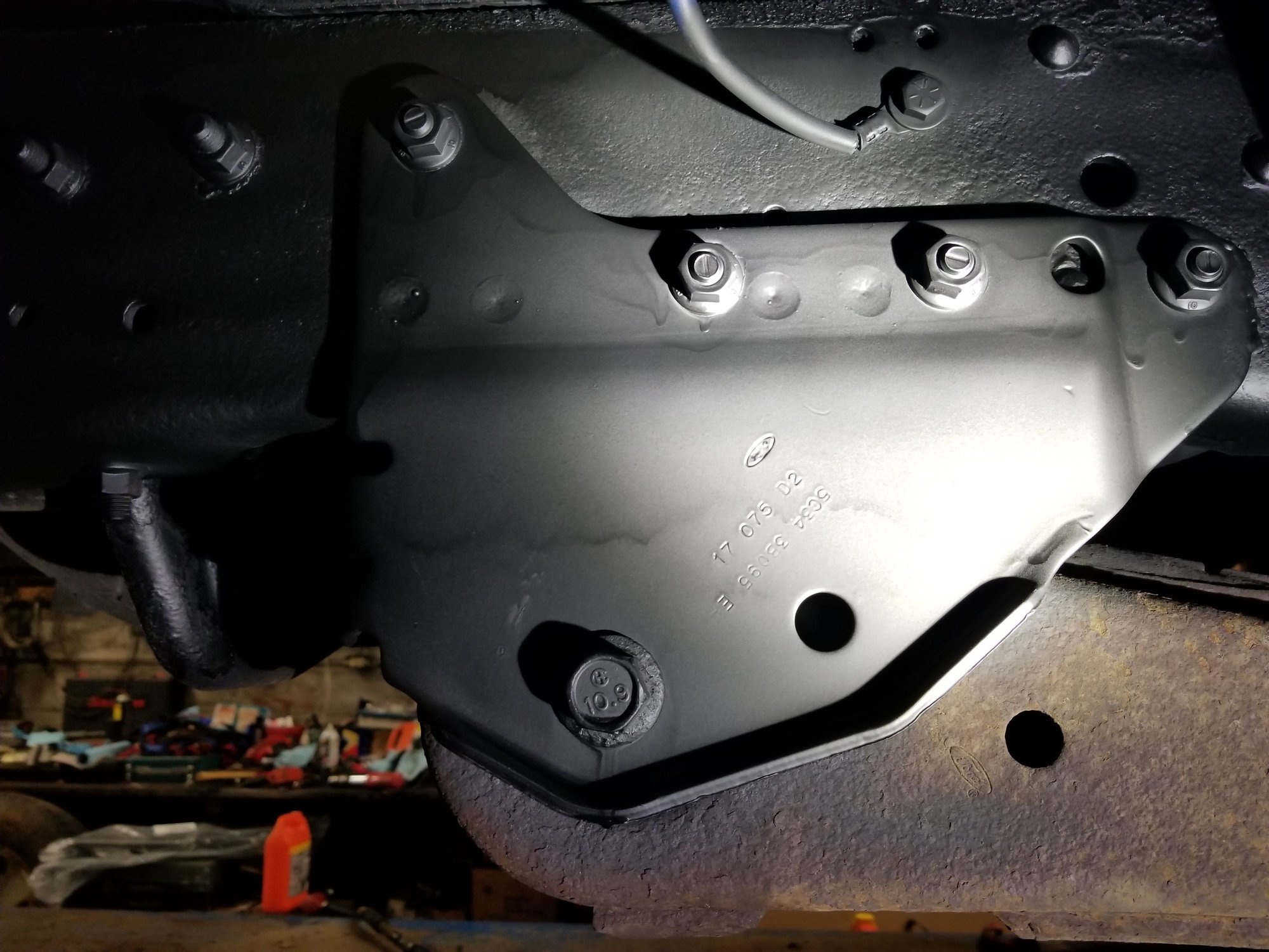

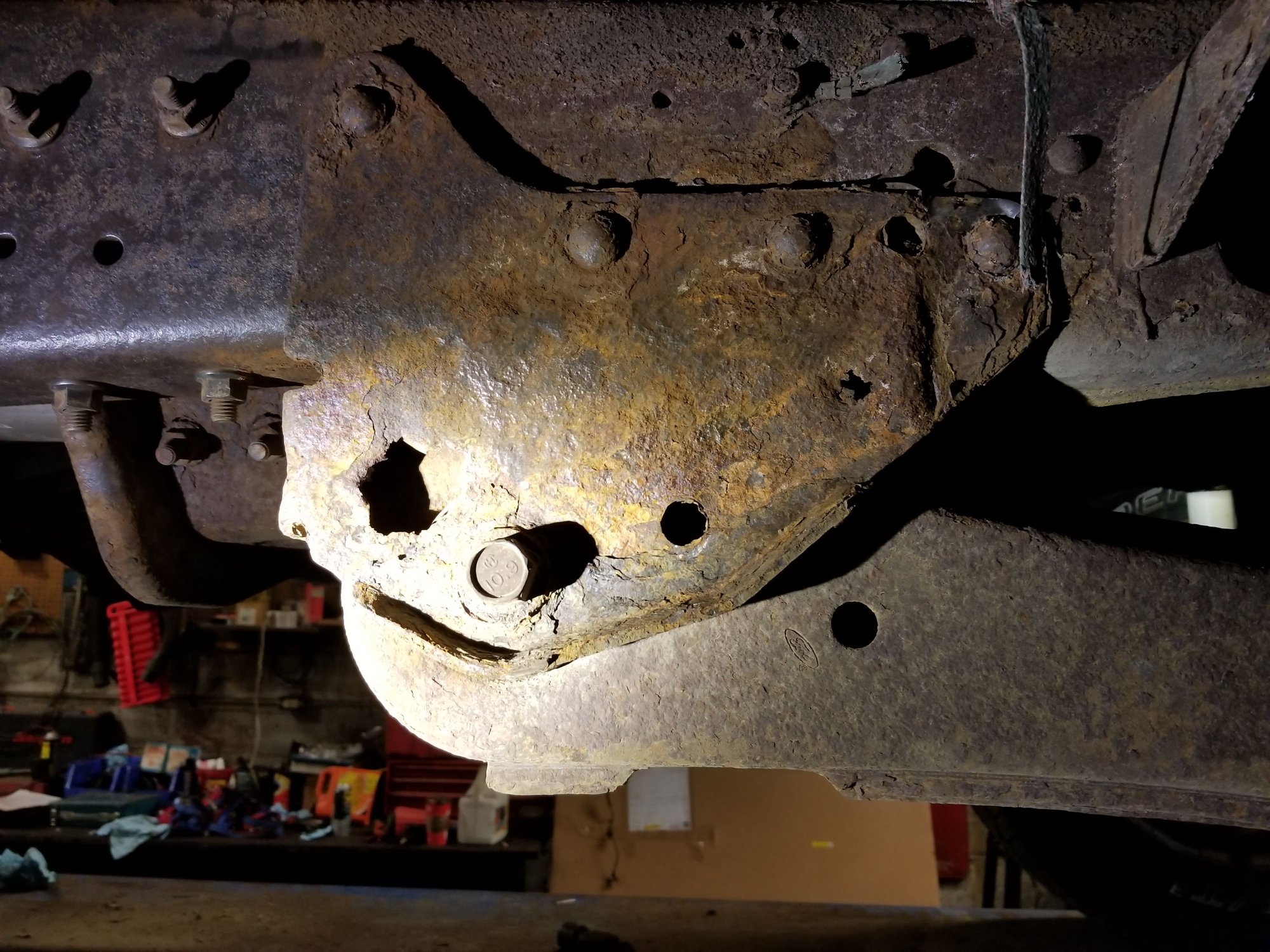

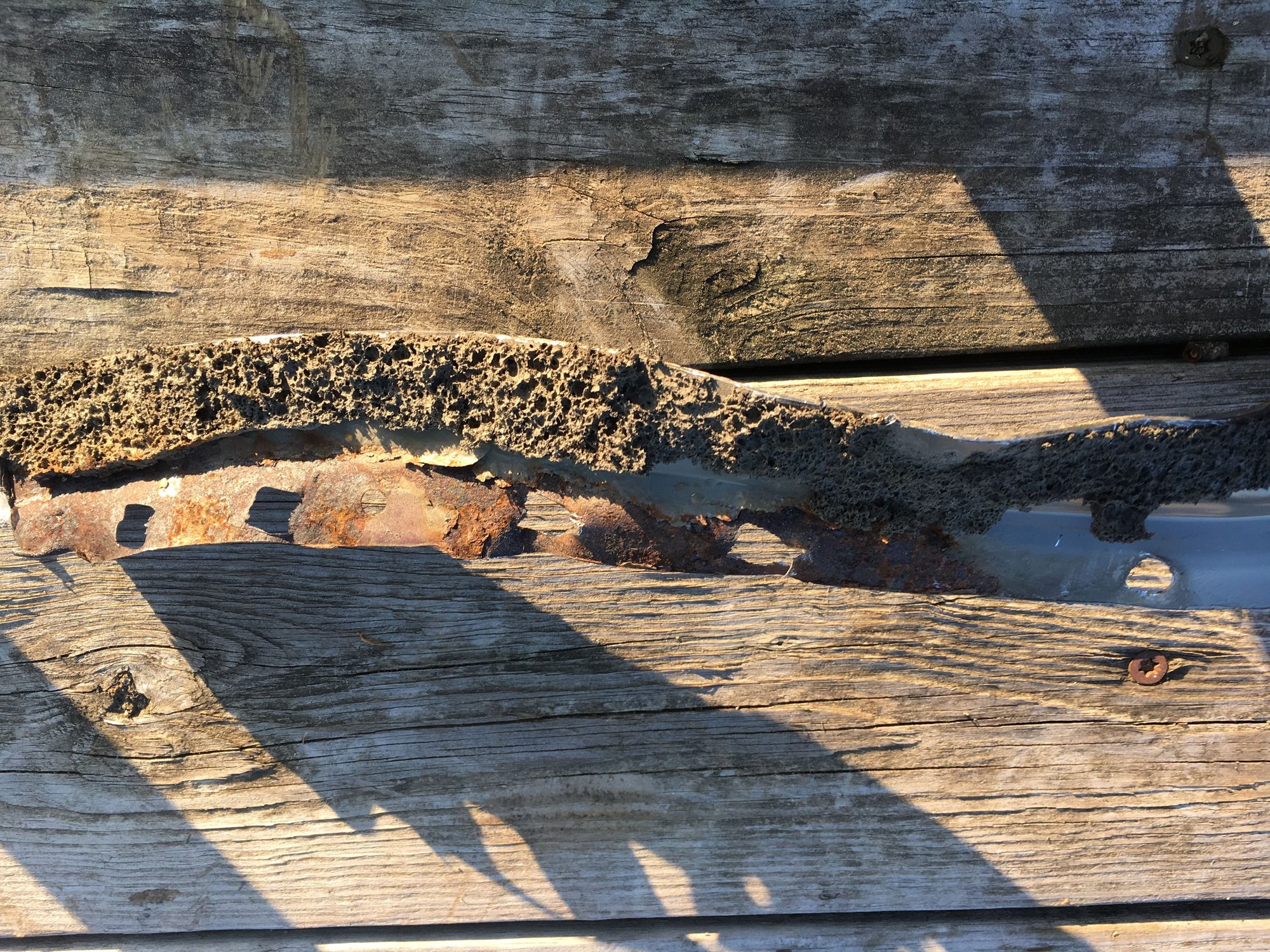

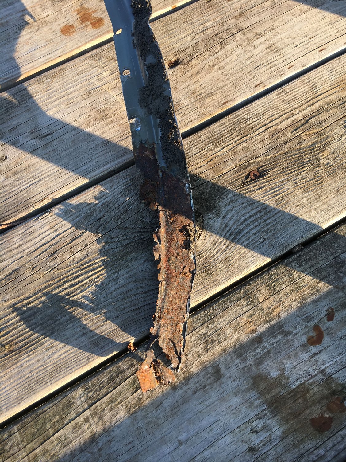

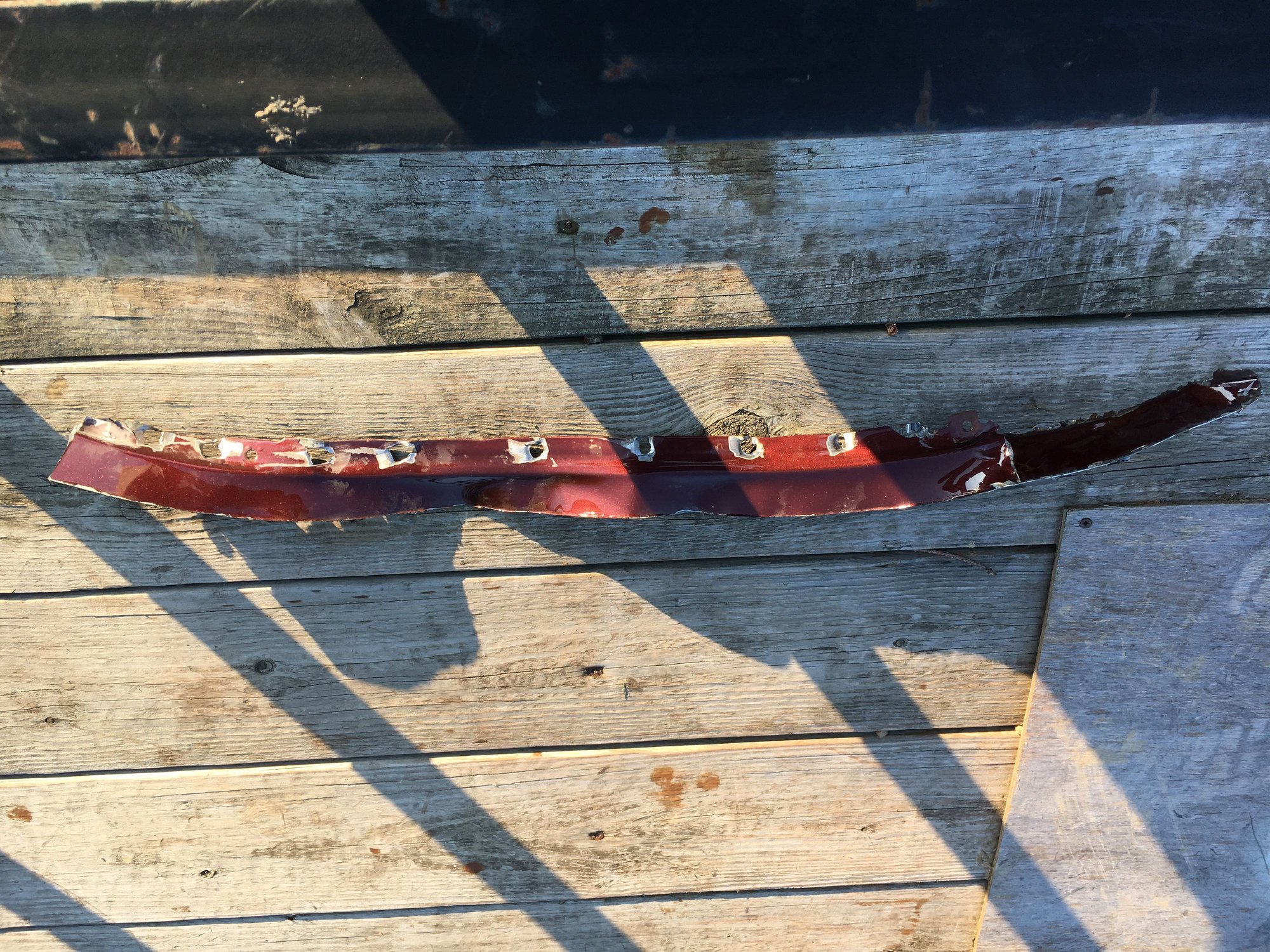

Here are some pictures of my 06. I am replacing the complete bed as we speak. I bought all new crossmembers thinking I would just replace them but when I removed the bed it was way worse than I thought. I just bought a new "Florida" box and It is being painted now. Here are the pictures of my radius arm brackets I replaced because even they rotted out! Before and after pics .....

Wow! That's surprising to me....but then again. My 01' F250 is gone from the cab corners back, but luckily the frame and components are not rotted. That before and after looks great though, keep her going!
Anybody use/order one of these?......https://www.ebay.com/itm/1999-2015-F...-/401179264020 Are the fit and metal good? My options seem limited to LMC or Ebay for such repairs. Any other "budget friendly" options? This is a work truck that I'm "restoring" and just looking to keep going for as long as possible.

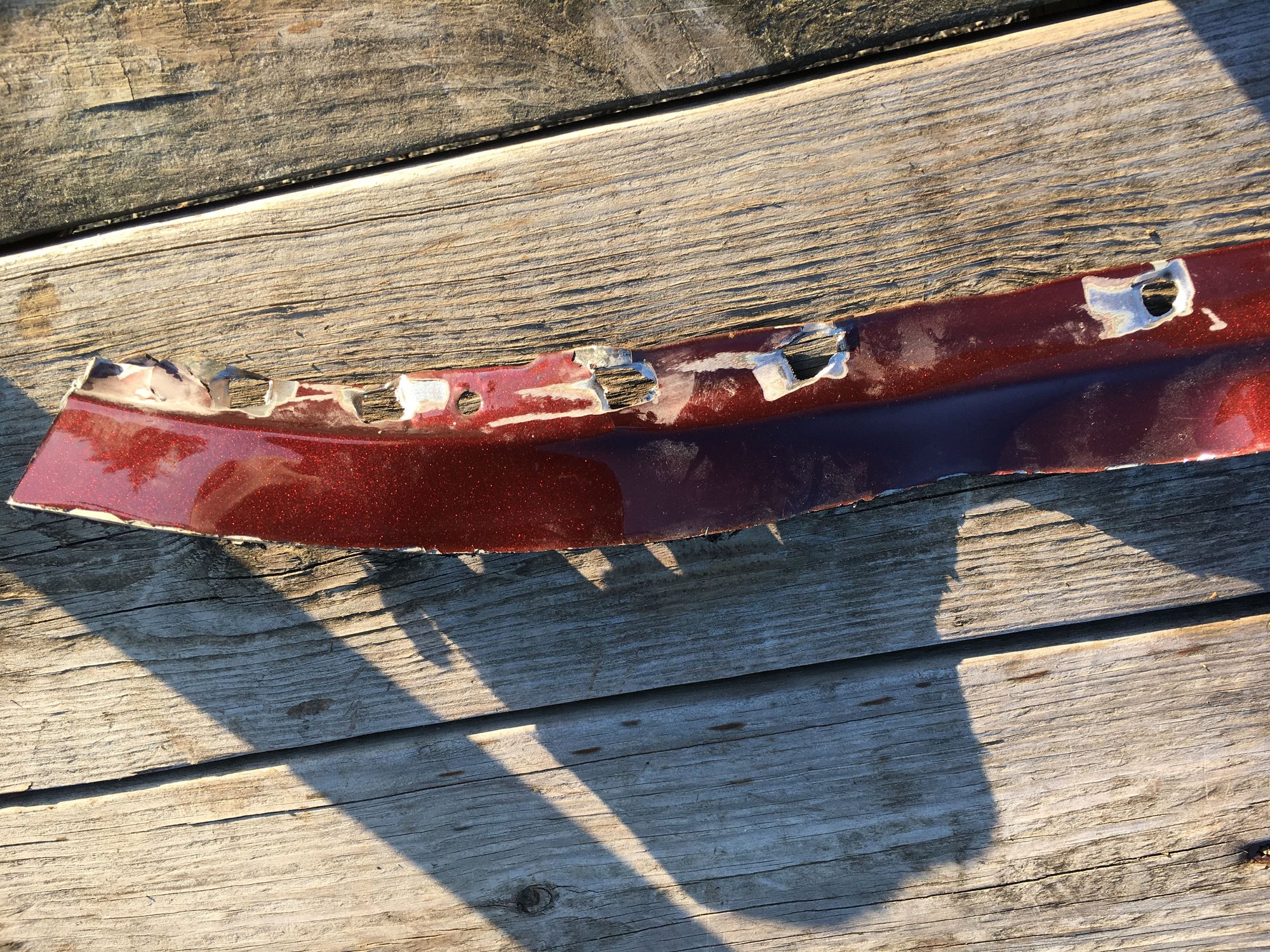

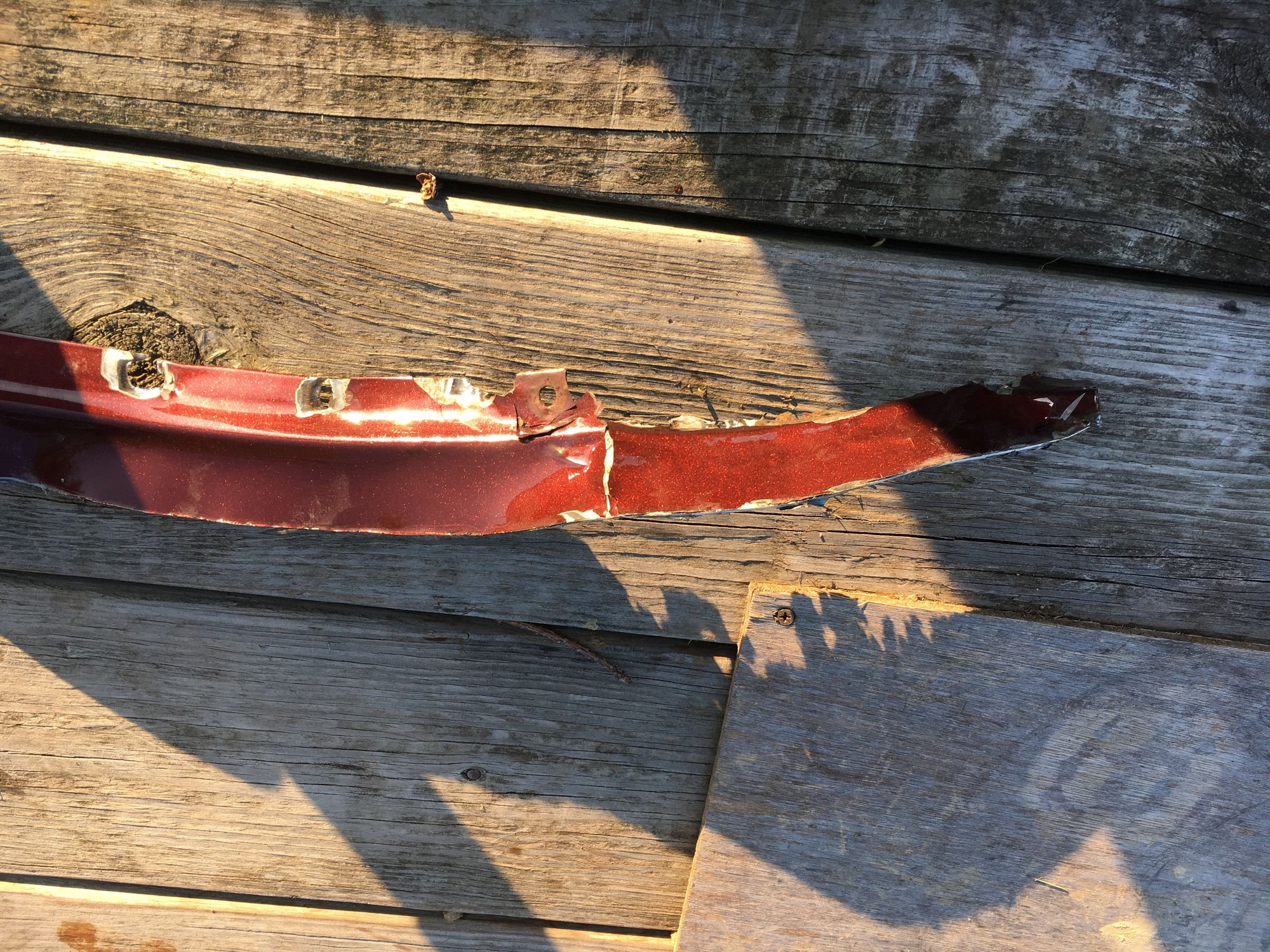

So got my 2010 little rust bubble fix. The shop showed me why the rust started in the first place. Ford put some kind of foam between the inner and outer wheel wells that trapped moisture. The pictures are not the best but I did the best I could.

My pops started about the size of a dime. No hole but just a little bump. The body shop I went to does a lot of Ford restorations and told me he has done countless bed repairs due to the foam issue trapping water. He did tell me there is no guarantee more rust wont come back and quoted me around $2K to replace the bed side.
