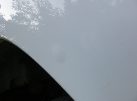

Originally Posted by Eatonpcat
My 2010 had the bubbling over the passenger side rear wheel, bought a patch panel and found someone to fix it ($800.00). Doesn't seem like they should rust this quickly, but what are you gonna do. I am sure it will continue to rust in other places, who knows??
2012 F250 bubbling starting driver's side rear:

Yous do realize aluminum has been used on the cabs or semi trucks for how many years now with I'll side effects from steel bolts holding parts together. Also aluminum beds are used on duno truck trailers etc again with nonilknside effects from steel fasteners or sitting on steel frames
