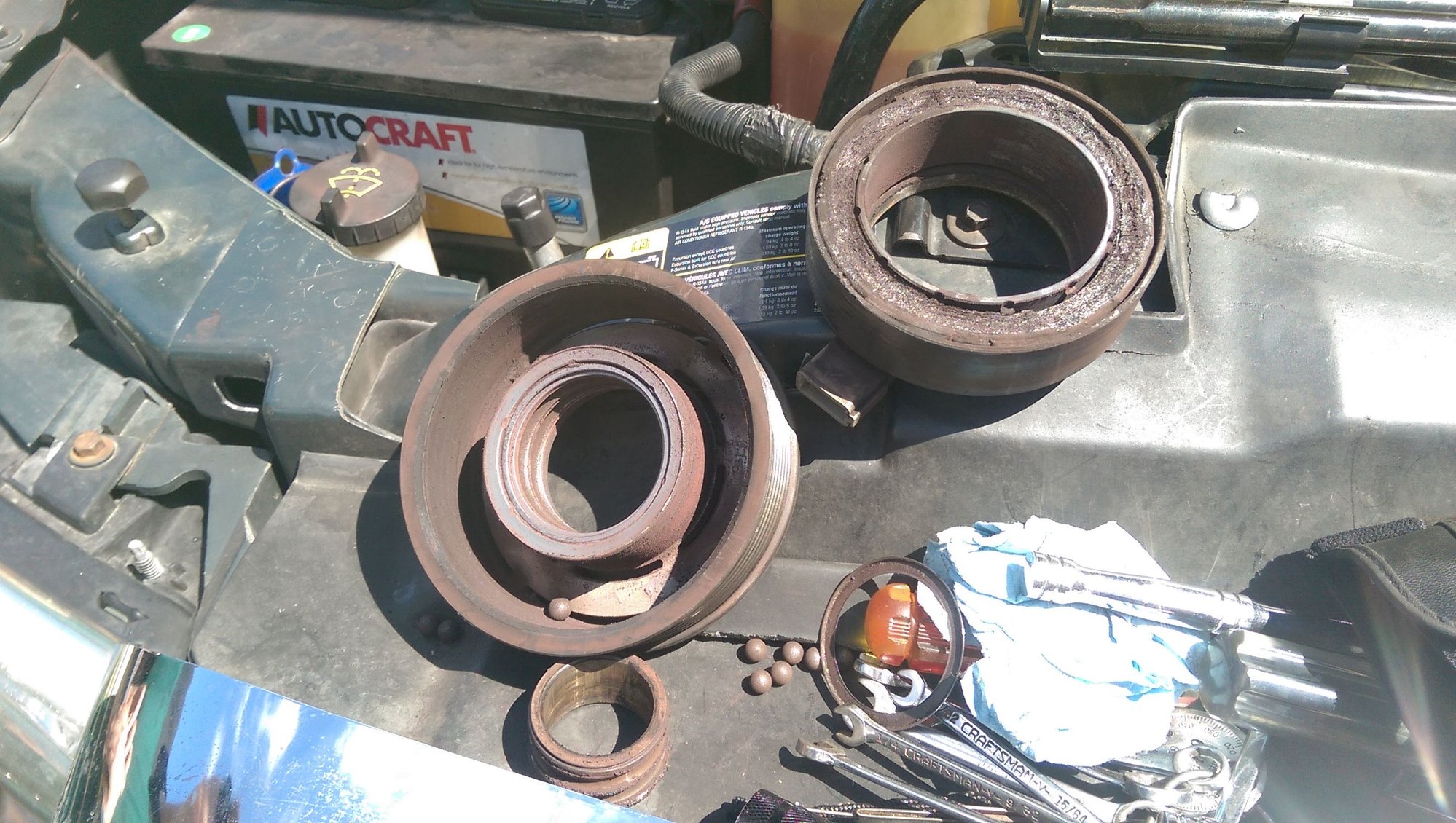

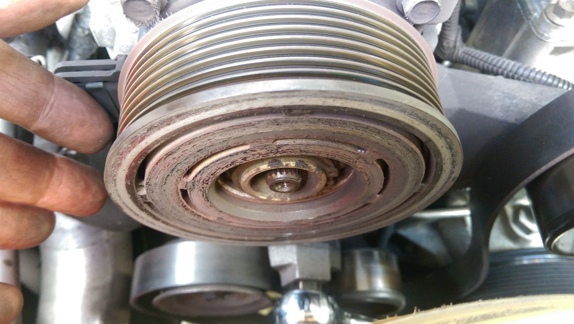

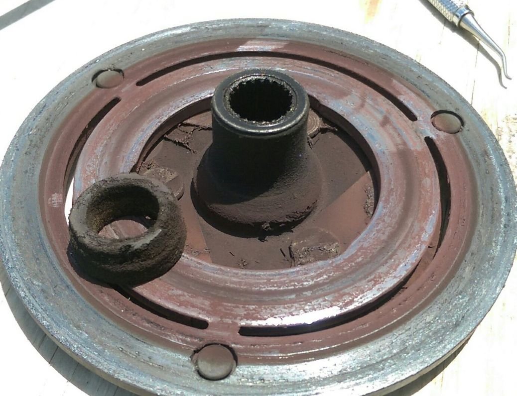

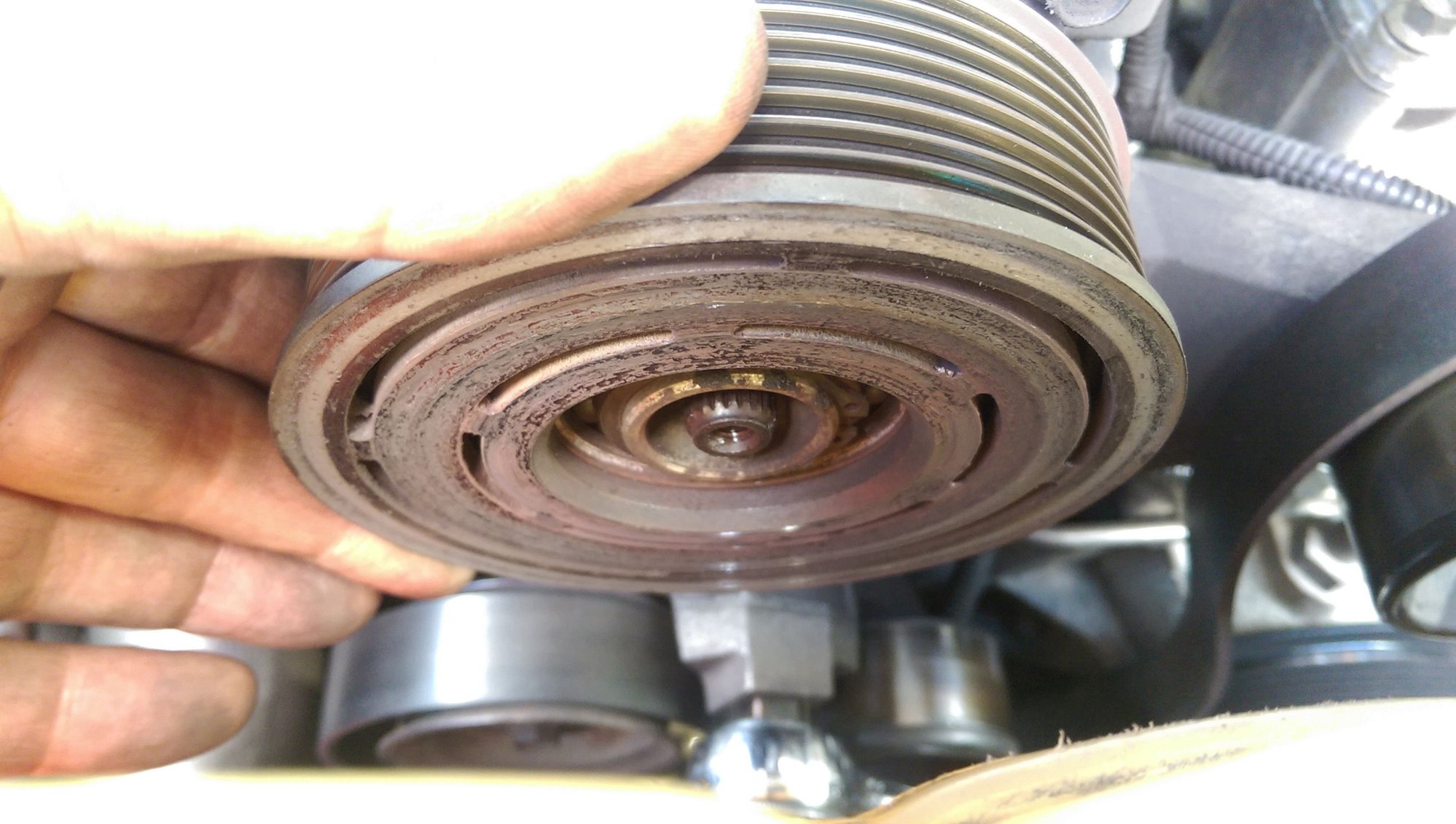

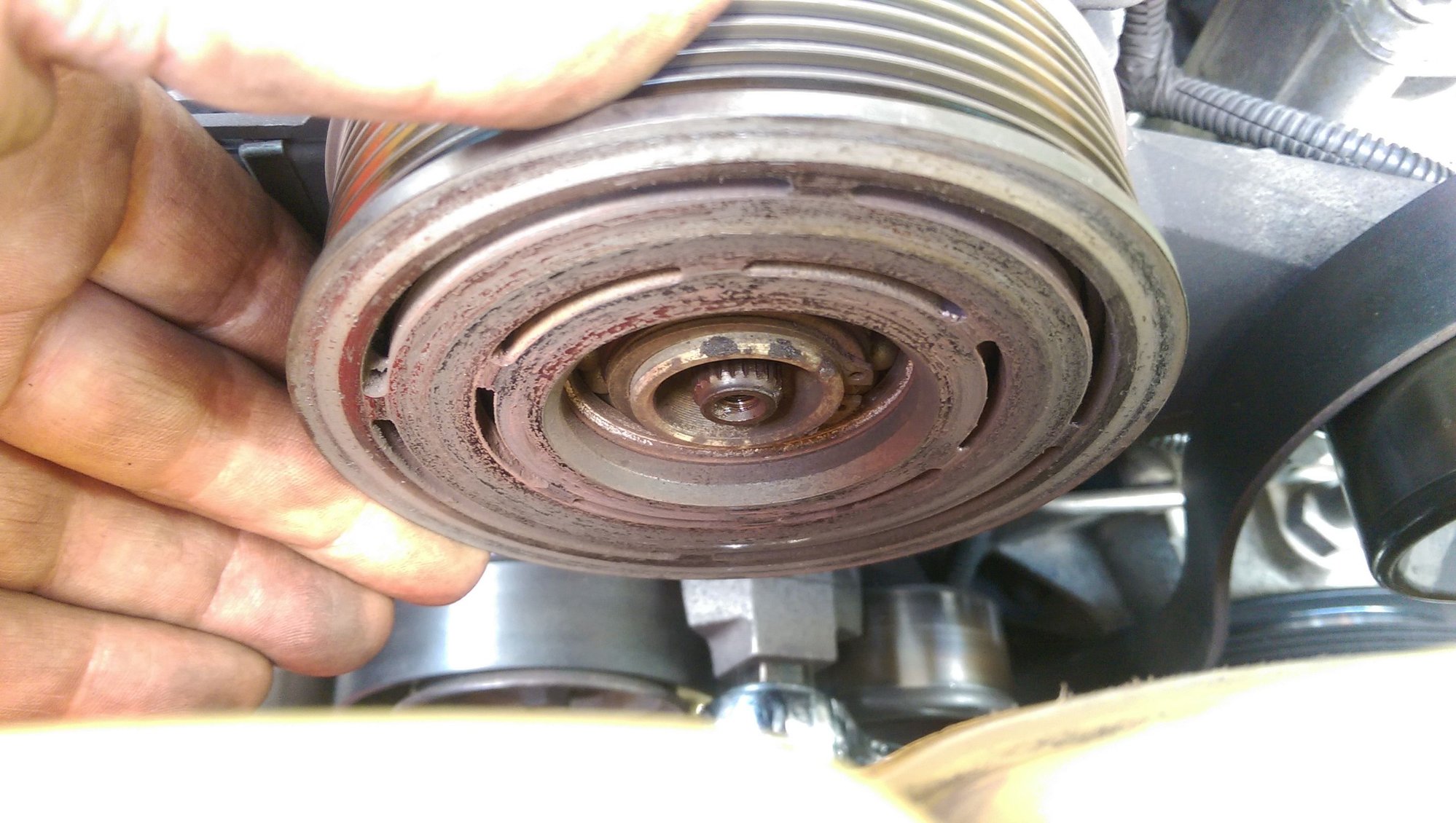

CARNAGE!
Some pics of the carnage. Can you spot the problem in the first 3 pics?
If you missed it, look again- focus on the center hub and the distance between the pulley in the center area...
A handful of bearings fell to the ground upon removal, but it wasn't "full" anyways
We had to remove the mounting bolts for the coolant reservoir as shown in Sous' linked video, then remove the 4 A/C compressor mounting bolts to pivot it upwards, blocked with a crowbar, so that I could get a 3 jaw pulley remover on it.
Had to do the pulley first, then the clutch.
In order to install, there were some scrape marks on the shaft that I scraped so they didn't continue digging in, and it was NOT going on.
A new friend suggested we either heat one side or cool the other. He said he's done them in the freezer when the shaft was removed. (Yes, I DID ask him "how big" his freezer is- not big enough for the Excursion )
So I had a can of compressed air I was blowing out the dust from the old clutch. I turned it upside down and let a little air out at a time so it dripped liquid CO2 onto the shaft until it turned frosty and stayed frosty.
When I used up all the air, I grabbed the clutch and pounded it on with minimal force
I reinstalled the clutch, checked the clearance with my .035 spark plug gap tool (smallest I had) with the thickest shim. Too big, probably .040.
Checked with no shim, way too small.
Eventually settled on one of the middle thickness shims that seemed to be the right size. Tightened up, tested with engine off via pressing the A/C button with the key on/engine off.
I took a video, but not sure if/when I can get that up to Youtube until I get back.
It was definitely a "Make you walk" situation brewing....
Thanks again for all the input, tips, info, suggestions, etc

There is also some kind of fiber cone inside the splined shaft. It was coming out as I sprayed the compressed air (normal way, not liquid), but I reinstalled it.
Here is a pic:
