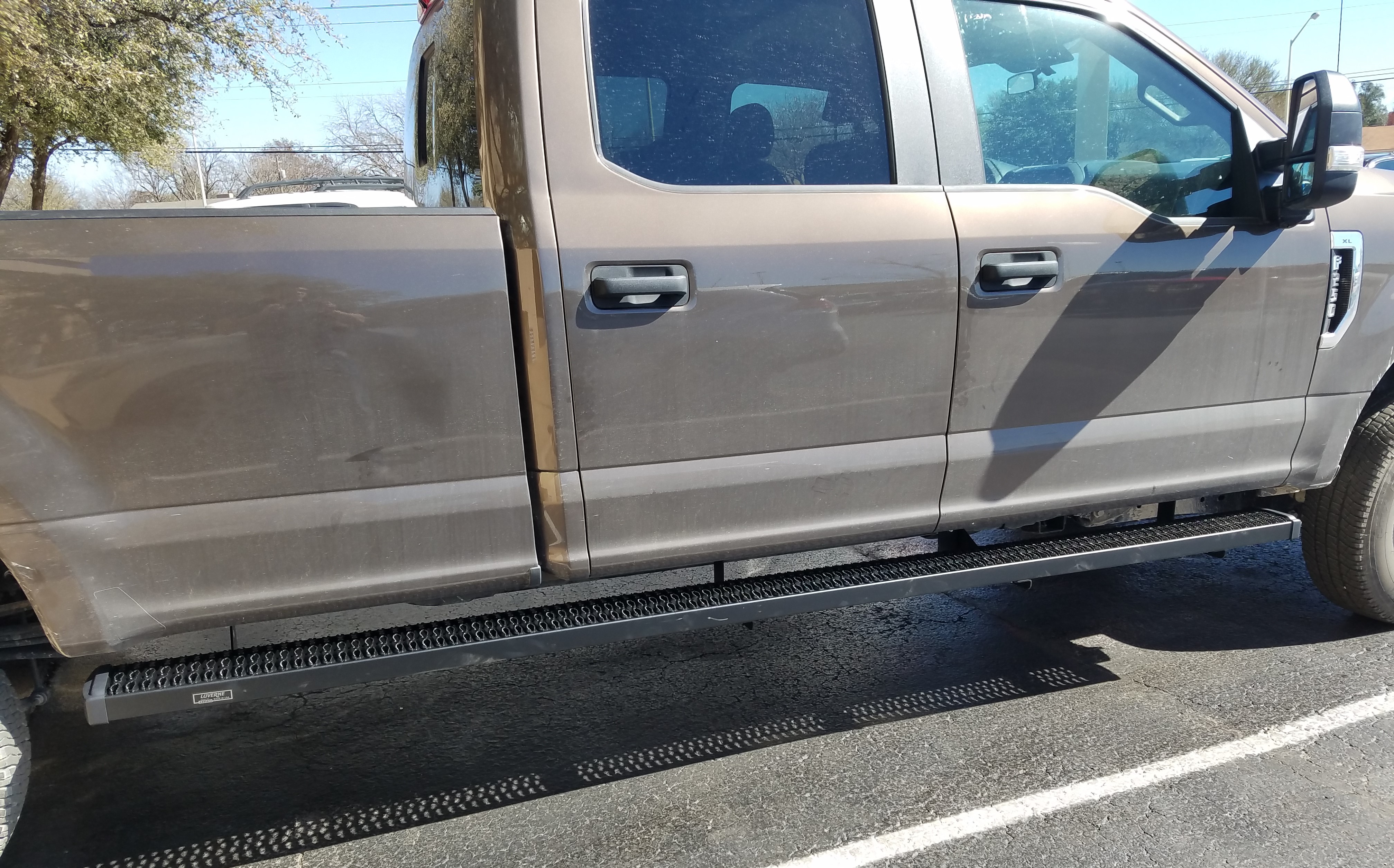

I did end up going with the Luverne grip steps, wheel to wheel, for CCLB. I've had them for a few months now and they are wicked awesome.
You can get your whole foot on them, the protect the rockers extremely well, and are very very solid. The end caps on mine are actually metal, there is 0 plastic anywhere on the boards
Cleaning them is a breeze with the grating. They are ridiculously grippy, even in rain or mud there is 0 chance you will slip off without trying. They stick out just enough that car doors will contact the board before your door which is a plus. Not far enough to have to consider when parking or turning tight though. They also do not hang below the frame rails, so ground clearance isn't affected.
Of note: if you do go this direction, it is definitely a two man job. The rear mount for the boards actually connects to the rear leaf shackle mount! Do not try to do this your self unless you get the cab only model.
They are pretty expensive, but in my experience worth every penny. Just let me know if you have any questions about them.

That's nice coverage wheel to wheel 17CCLB250. Saw these on the Alaska thread, great utility.

Yep that's where I first saw them too. Took a bit of tracking down to finally get a part number and price. As you can see in my picture, everything is frequently dirty. I am under 6'4" tall so having access to the tool box without having to always get up close and personal with the side of the truck was a must.
Getting in from the side still requires the old side step -> tire -> swing leg over maneuver though.

That is awesome. I've had them book marked since the Alaska thread. It's nice to see a better shot of them on a SD. Thanks for getting those up!!
Yep... they are not cheap. I've been checking and you can get them for a little less at a few places but not much off. Thanks again!!

Could you please tell me how they are mounted,,,
Did you have to drill any holes?
Are they all hard point mounted or are the brackets connected to the sheet metal?
Thank you

Nope, no drilling whatsoever. The rearmost mount does attach to the rear leaf shackle, and the other three mounting points use the studs/mounting points that the factory boards use. Even if you didn't get factory boards, you should still have the studs/mounting points there. I believe they are on every truck regardless.
These points are not on the frame, they are on the body however. I asked around when doing my research and nobody made any kind of boards that were frame mount (at least not yet).
The mounting brackets for the boards are ordered as a separate part number, and contain everything you need. There is no drilling/tapping required. All bolt/washer/nut hardware.
