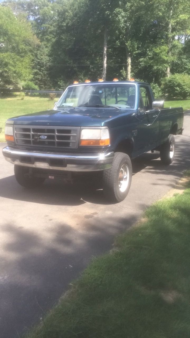

Silly question, but could you post up a photo of your truck?
Red
Old Jul 10, 2017 | 06:15 PM
pstrokemike97's Avatar
pstrokemike97
Joined: Jul 2017
Posts: 47
Shes a beauty
Old Jul 10, 2017 | 06:23 PM
Red97350's Avatar
Red97350
Joined: Oct 2009
Posts: 882
Likes: 11
From: Eastern CT
Nice. A set of Alcoas will make that truck really shine.
Red
