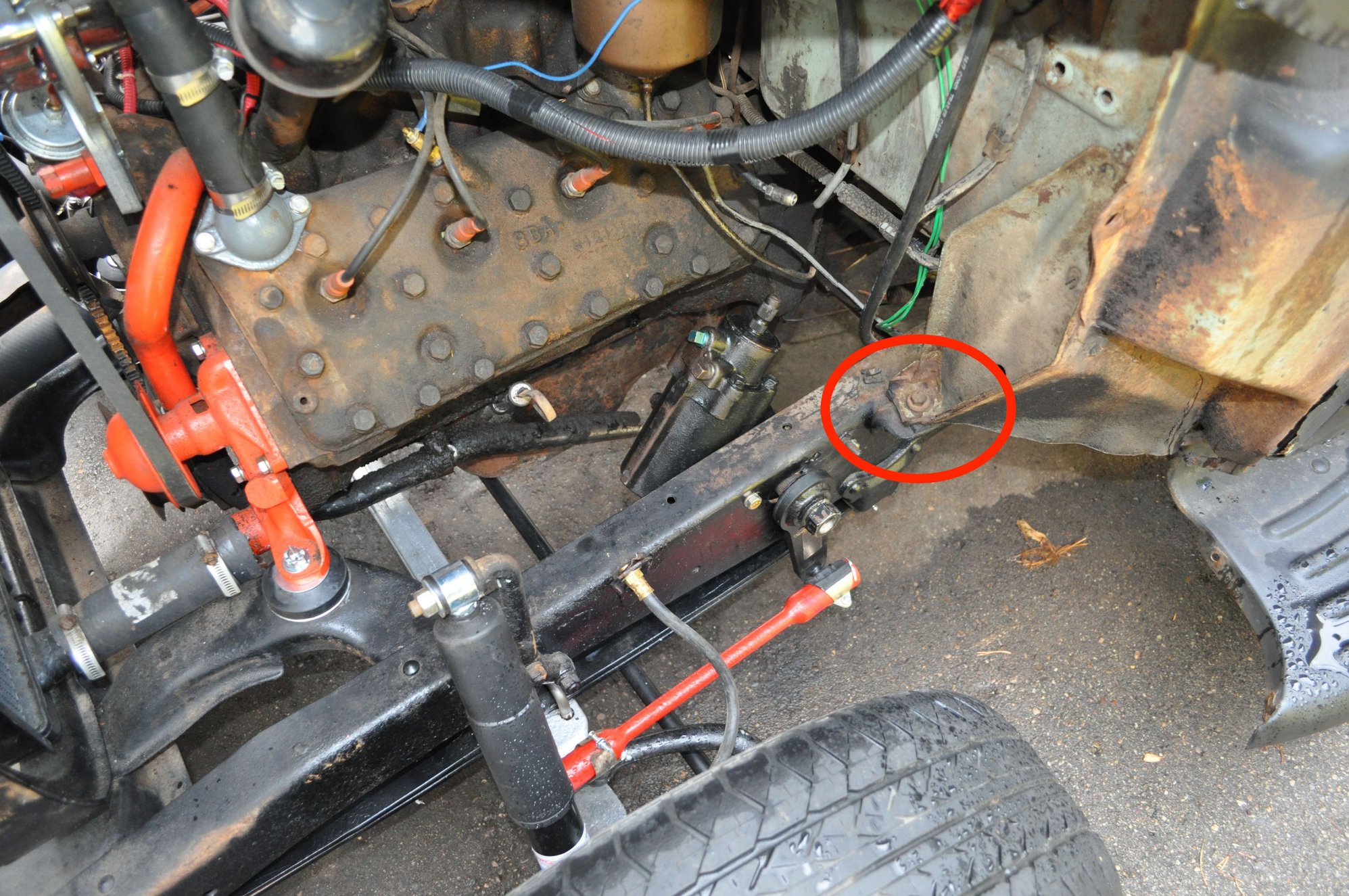

Bad body mounts can cause the hood to pop open. Slight looseness at the mounts translates into significant instability at the front of the long hood.
From LMC catalog
You will have to fiddle with getting the pin centered to get the hood to open. Then readjust it back to its previous settings. Then replace the worn mounts. Short term you can just try tightening them but the correct fix is to replace them. Also look for wallowed out frame mounts.
