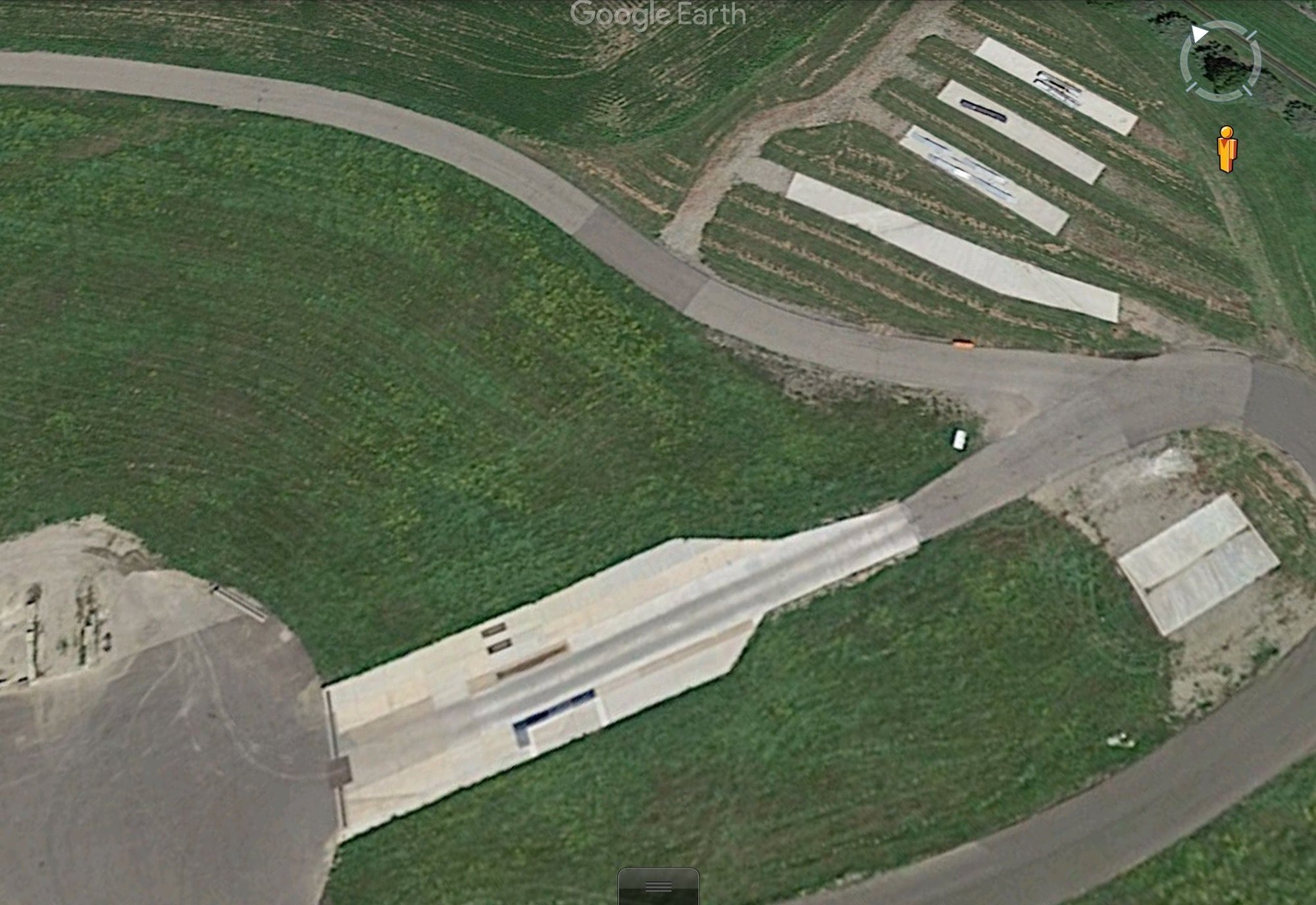

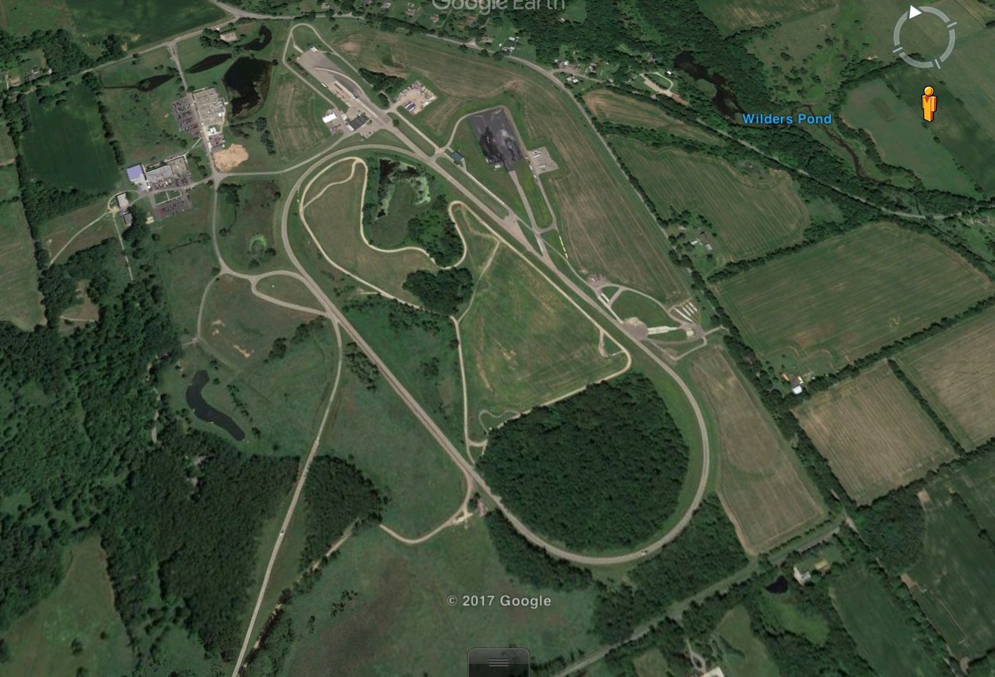

I can't find the images of a test in progress.
This is the track:
The grades are mostly used for parking to meet NHTSA 20 and 30% standards, but the three to the upper right are more used for the military testing with varying mue surfaces. The split traction surface plates are to the sides on the main slope.
This doesn't bring anything to the discussion of lube or additive, but thought it might be interesting as most never see the R&D facilities.
