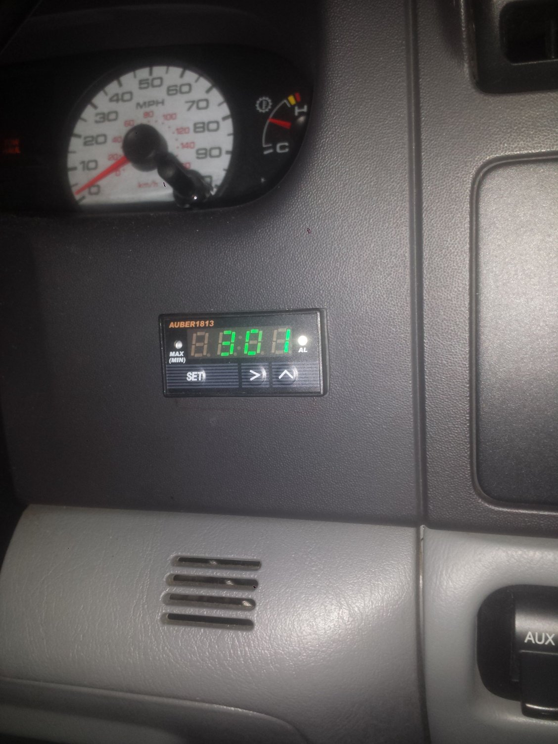

Just by luck, I was doing a Google search for a Pyrometer that was quick and easy to install. Well I really like what I got and the price is very good in my opinion:
EGT Digital PMD1XT Pyrometer Gauge + Probe Kit - Diesel Race Series DF - $125.50 from The Sensor Connection
I bought the optional enclosure kit, but I'll let it be for now. It has a programable Alarm that I can't change right now due to my not taking the time to understand the procedure. Anyways this was easy as pie, less than one hour total including tapping the manifold. I got the 6' thermocouple.

Looks good. Any trouble tapping the manifold?

That's an Auber Digital gauge. Awesome product, comes in red, blue, amber, or green. Programmable set point alarm, and the probe, even capable of a sound if you hook it to a speaker.
EBay carries them also, a little cheaper.
Chet, set the high point to 1200°, so when it goes off , you let up!

Yes thanks I will set the alarm as soon as I can get into the Alarm program menu. It kicks back out when I go menu 1. Drilling and tapping the manifold was easy. Having a super strong Neo magnet attached to the tap helps pull the shavings out. I also put the magnet on a screwdriver to get every last bit of metal out.

I got mine on ebay in green years ago. Haven't had any issues with it at all. Alarm is @ 1250. I used a mini piezo speaker from RadioShack for the audible. Mounted mine up here.

I figured it out, I was using 1000 instead of 0001. This plus an android Head unit with Torque Pro and what more can you ask for.
