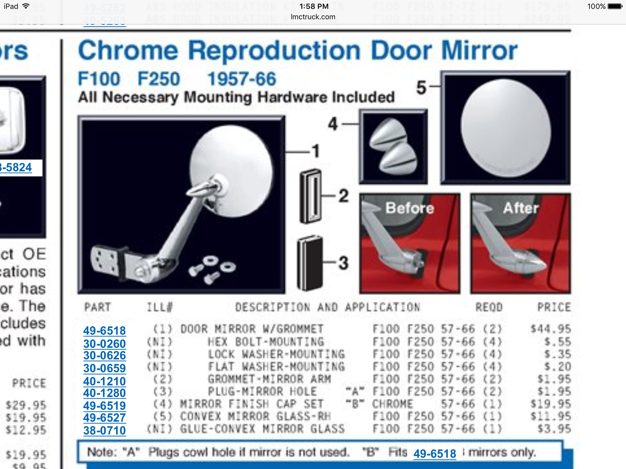

LMC truck sell them. Dennis carpenter as well but they say they are out of stock. ,Doug.

Reproduced, EVERY Ford repop seller has this mirror.
FoMoCo updates/replaces part numbers almost as often as women change their minds!
The original (1953/56) part number was BAAA-18402-A this was later replaced by FoMoCo with B5C-17696-A and in 1961 was replaced again with C1TZ-17696-E
Originally, the mirror head was available separately, but when Ford changed the part number in 1961, the mirror head was only available with the mirror, and...
The 1961/66 mirror looks different than the 1953/60 mirror.
Repro mirror pics: See that pointy thing in front of the mirror head? That wasn't there originally, because this is where the replaceable mirror head threaded on.

Sorry about the sideways rotation. Just turn your monitors....lol.
One other thought - the mirror heads are available separately and are held in place by an allen set screw, not threaded. The pointy thing in front of the mirror head is correct. I have NOS ones of the complete mirror, just the head (shown in the picture), and just the bracket with attaching parts.
Rear View Outside Mirror Head B6CZ-17723-A 2
You can maybe see the recess in the mounting stud on the backside? That's what the set screw seats into.
