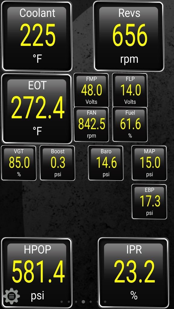

This is a screen shot of a vehicle at idle. It was driven for 3-4 miles before I put an OBDII device on it. Owner is my BIL, he was attempting to drive to my house.
I know how bad it is.. what say you?

...I'm not seeing it?

His voltage is fine .....

Toasty in there.

Yesterday, it wouldn't start. We charged it all night. FICM was 35.7v. The seller towed it to the school. Full of water because it over heated. They drove it home, over heated on the way, filled with green coolant. puddle of water under the tail pipe yesterday. Oil as black as coal. #2 injector contribution, P0404, black smoke on throttle, clouds of white smoke, heavy puking, new degas tank, the old one exploded and had a hole drilled in it to relieve pressure. No power, turbo doesn't move.

I'm going to say it's ALL blown; EGR cooler nuked the heads, now both are thoroughly trashed, repeated overheating has probably roasted a few other things (or filling with water when hot) like maybe an injector cup, fluid in the exhaust has somehow only rusted up the turbo and hasn't ended up in the intake to the point it locks the engine. Oil temps aren't quite to the point that I'm asking if you've checked if the oil filter standpipe is melted or not, but if that data was from cold on a short drive that's a real possibility.

They called and said.... Well you have a 6.0 and we figured you'd know what to do. I said "drive it back, you spent $4300 for nothing". They are not happy. He said he could maybe trade for a 6.4 and I said I will not be helping with either vehicle.
It's trash. Head gaskets are toast, oil and EGR cooler are gone. FICM is done, and when I said $10,000 minimum she about passed out. What's really funny, the family thinks he's a car guy and you can't tell him anything.

Bryan... The rig made it 3 miles and shut down with high temp. I read that temp after it sat for 20 minutes cooling off, it was probably 300° + before I got there and BIL said it looked like Old Faithful!

Need a long block or salvage engine,that ones done it time.
