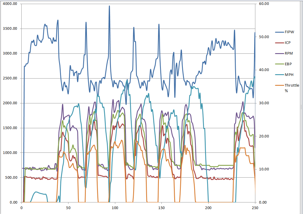

I have the data logger working now.
This is just some stop and go driving

Hey she seems to be over it. She made the run form Industry to Pasadena
with the data logger running, and the run home w no issues. Back to Pasadena
and back on the 4th. She seems right as rain again. I did a on-ramp romp she does 20 psig of boost.
