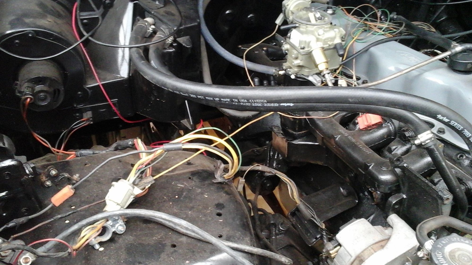

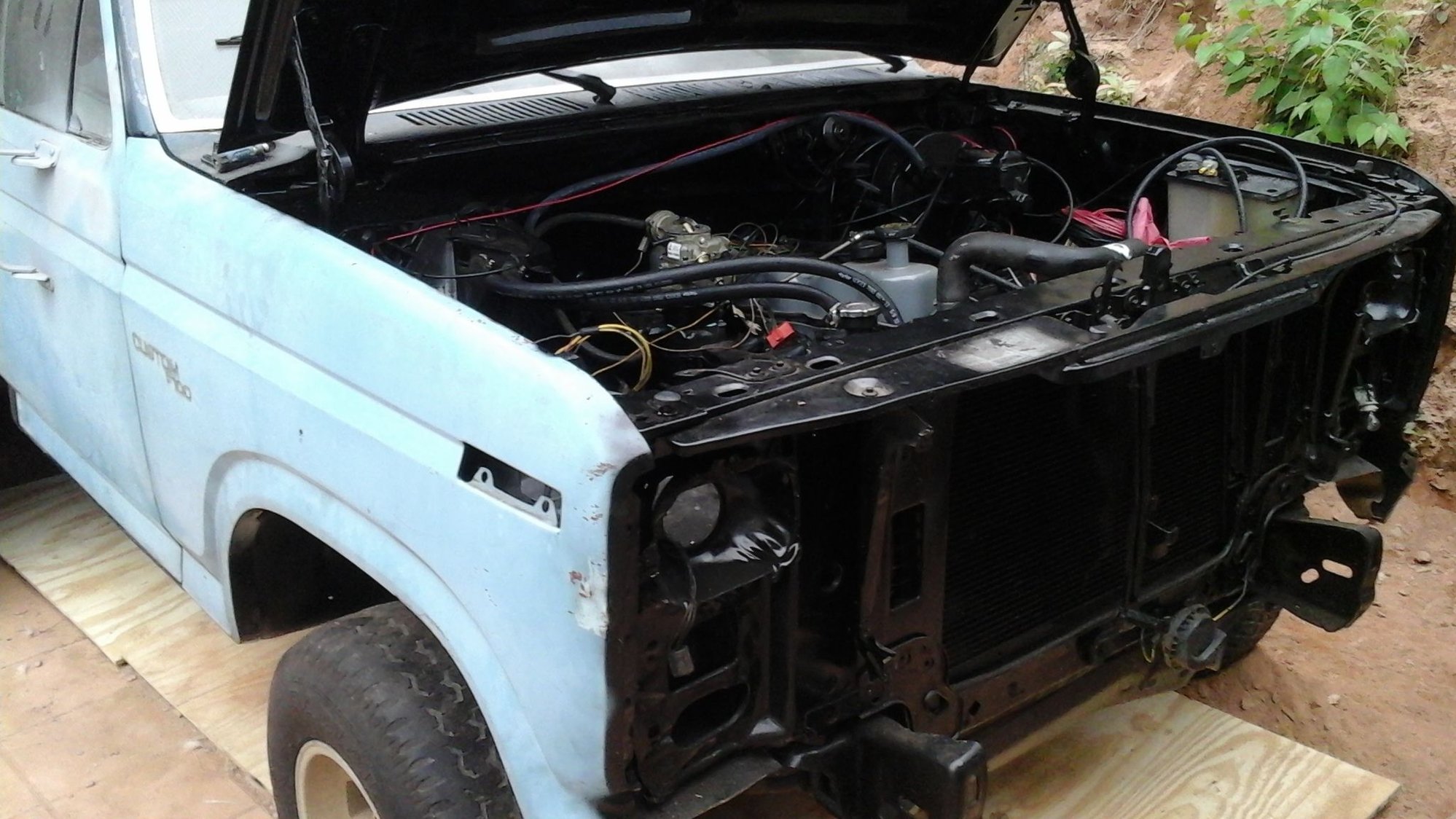

Here's a few photos of were I'm at been to hot to get out and do a lot lately
Egr replacement spacer and new nonfeedback carb
