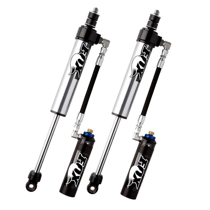

Does it have the castor bushings? the fox shocks are for 2" lift right?

The shocks are for leveled trucks. I am taking it in today to have the alignment and all front end parts checked and hopefully fixed. I bought 2 degree bushings a few weeks ago and have them in a box if the event that it will help. I can't tell you how much I hate the way it currently drives down the road but, everything else about the truck is good.

I have a platinum that's exactly like the one described above minus the adaptive steering and I have done all of the above to it including the caster bushings, fox shocks (for a 2" level), track bar bracket, & dual steering stabilizer. Nothing's works! The steering shake is just as bad as the first day i put the 2" leveling kit on the truck. I just got done talking to a guy at Ford and he said to try putting 80 psi in the tires 😐. I'm going to try it but I'm pretty sure it's not going to do the trick and my truck will ride like crap. I'm at a loss of what else to do at this point. It's really getting annoying .

Hopefully they figure it out for me today. For what it's worth, I did install the fox mono's on the front and still have the same issue. If the shop can't figure it out completely, I will ordering a stabilizer and if that doesn't make it tolerable, I will probably admit defeat and get something else. :/
