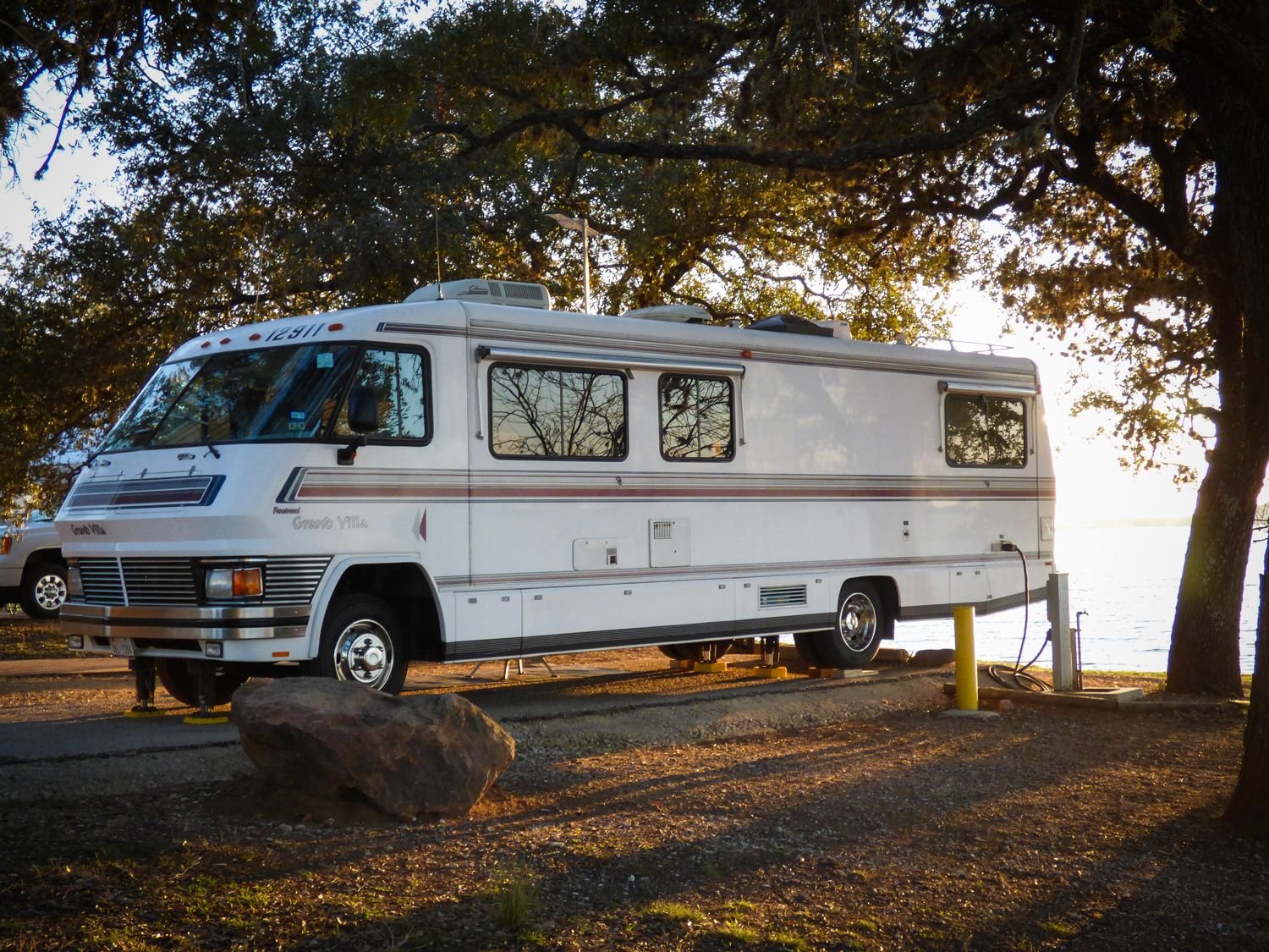

I am having a very hard time trying to locate a tranny for my motorhome and was told to check with the folks here. What I have is a 1990 Foretravel with a 460 and a C6 tranny. I have a tag number of PDJ BC2 L27C E5TP DA . I spoke with ford and they cannot find anything on this. I did some online research and found numbers close to matching an 85 E350. ( which is strange because the tranny is original in the RV. Anyway, if there is anyone who can decode my tag I would really appreciate it. I would like to get a new tranny.

It's a Class A front engine. So it really doesn't matter what tranny I get as long as its a C6 Big Block? NO differences? I assume the only differences would be the torque converter? It's actually on a Oshkosh chassis rated at 18,000lbs.. its not a little rv hahaha. FYI, I am looking for a re-manufactured unit which is where the problem starts because the re-man companies want an application for the it for warranty. One said that if I ordered a tranny for a f250 but put it in my RV it would void any warranty. That's why I am trying to decipher what the actual tag fits.

Thanks for your comment tjc transport. Unfortunately is is NOT an F53. It is an Oshkosh chassis. Most of the problems I face when trying to locate parts is I need to look under 3 different things. The Oshkosh chassis which has it's own vin number which is used when calling Oshkosh ( now Frieghtliner ) , the coach vin number which is how its registered and then of course the ford drive line which in my case is a mix of all sorts of things. Of course there is "Foretravel" the manufacture of the coach. From an industrial 460 with hydraulic everything used in f650's or just a plane old 460 for the simple components.. now I have this C6 that nobody knows what it is LOL. Best I can come up with is that 85 e350.. So, My guess is, just get your standard c6 with a low stall converter or take mine in for a rebuild. It sure would have been easier if I had a regular RV that was all ford LOL.
