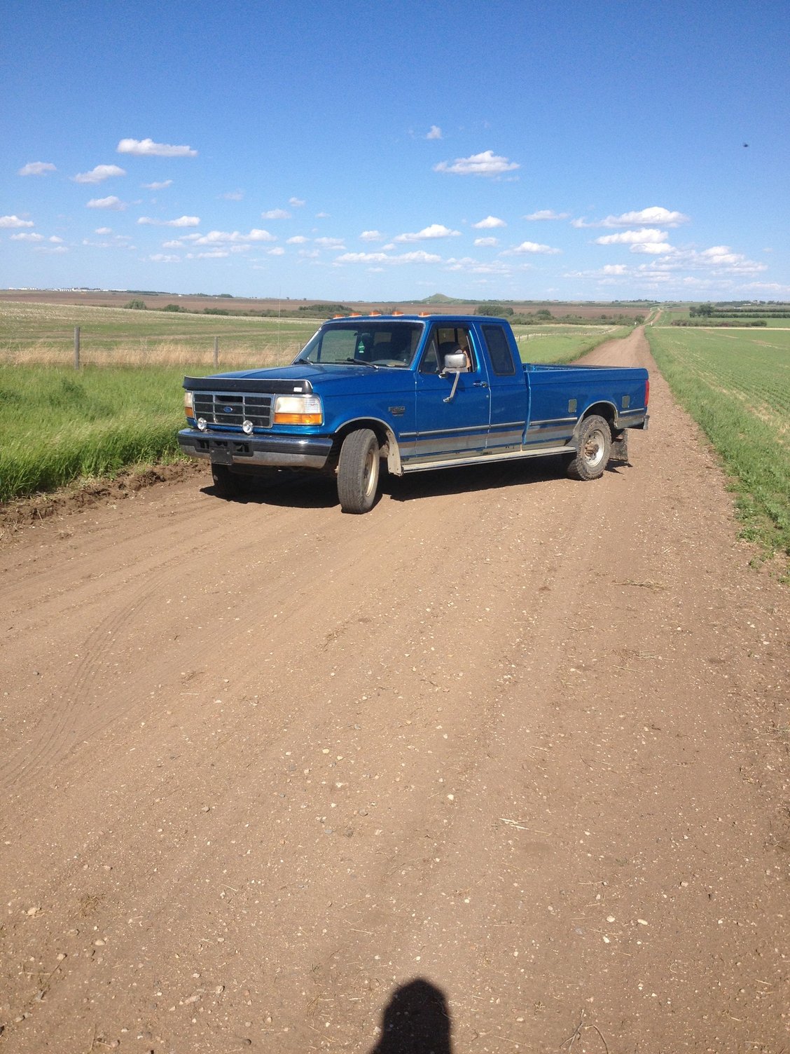

A bump to the top with a picture because we all like pictures

You ever figure your problem? Good looking truck by the way
