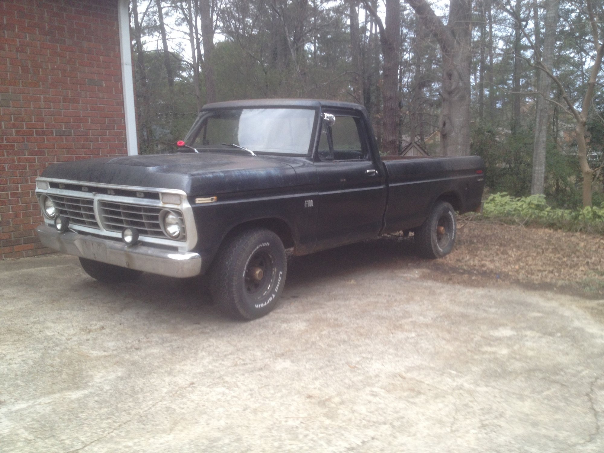

Here is a pic of Rusty because who doesn't like pics!? Thanks in advance, Andy
