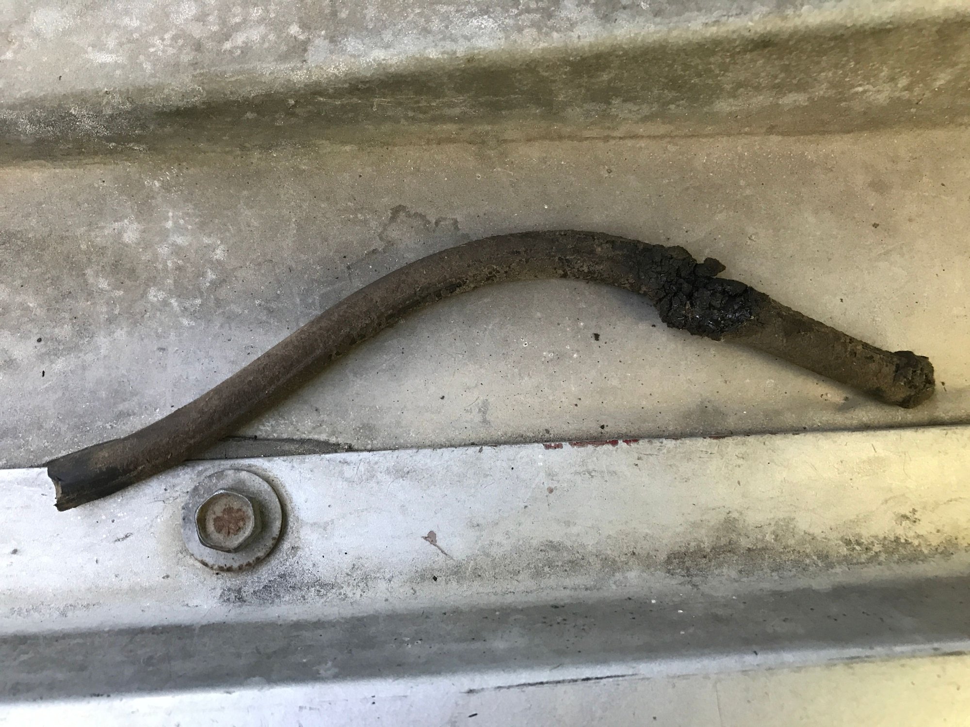

Also, unrelated, while on a short drive today, just after it really warmed up to temp (guage read about 190) the truck started shifting very rough and shortly thereafter did what I would call stalling out as I came to a stop sign. I pushed it over to the side of the road and let it cool down to about 150 Before it finally fired up. I suspected the diaphragm on the vacuum modulator was going out or not properly adjusted. Went to check for fluid inside the vacuum hose and it turns out I have a massive blowout in the hose . It was routed too close to the exhaust I believe.
Tough to troubleshoot a shift issue while stuck on the side of the road with a starter going out. Luckily I was only a about 1/2 mile from home and could get it started once it cooled down and take it back to my garage.
I'll report back back after I get a new starter and vacuum hose installed.
