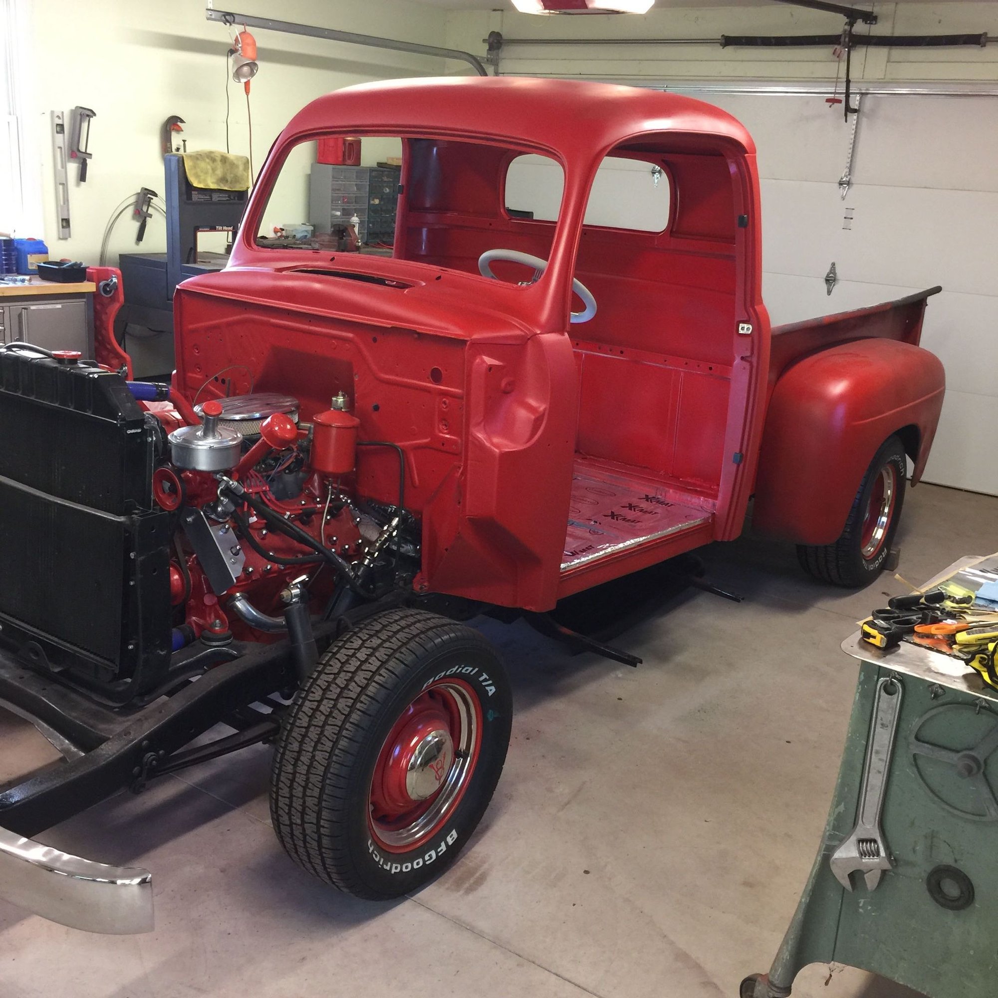

These are 15"x7" front and 15"x8" rear on 8.8" Explorer Sportrac rear axle which lets you use wide 60 series radial tires. Wheels are custom in order to get the '34 Ford artillery wheel look.

Pete - love the look of that truck. Looking forward to seeing it all put together.

[QUOTE=petemcl;17281761 Wheels are custom in order to get the '34 Ford artillery wheel look.[/QUOTE]
Just being pedantic.. please forgive me. The "wide five" or "artillery" type wheels used by Ford were during the years 1936-1939. Nice looking truck.
Thanks Fred. I should look up things like that. But I still like the look.
Me too Dave. I really like driving it in our private neighborhood but it is off Monday to finally have an exhaust system put on before the neighbors show up with the tar and feathers.
