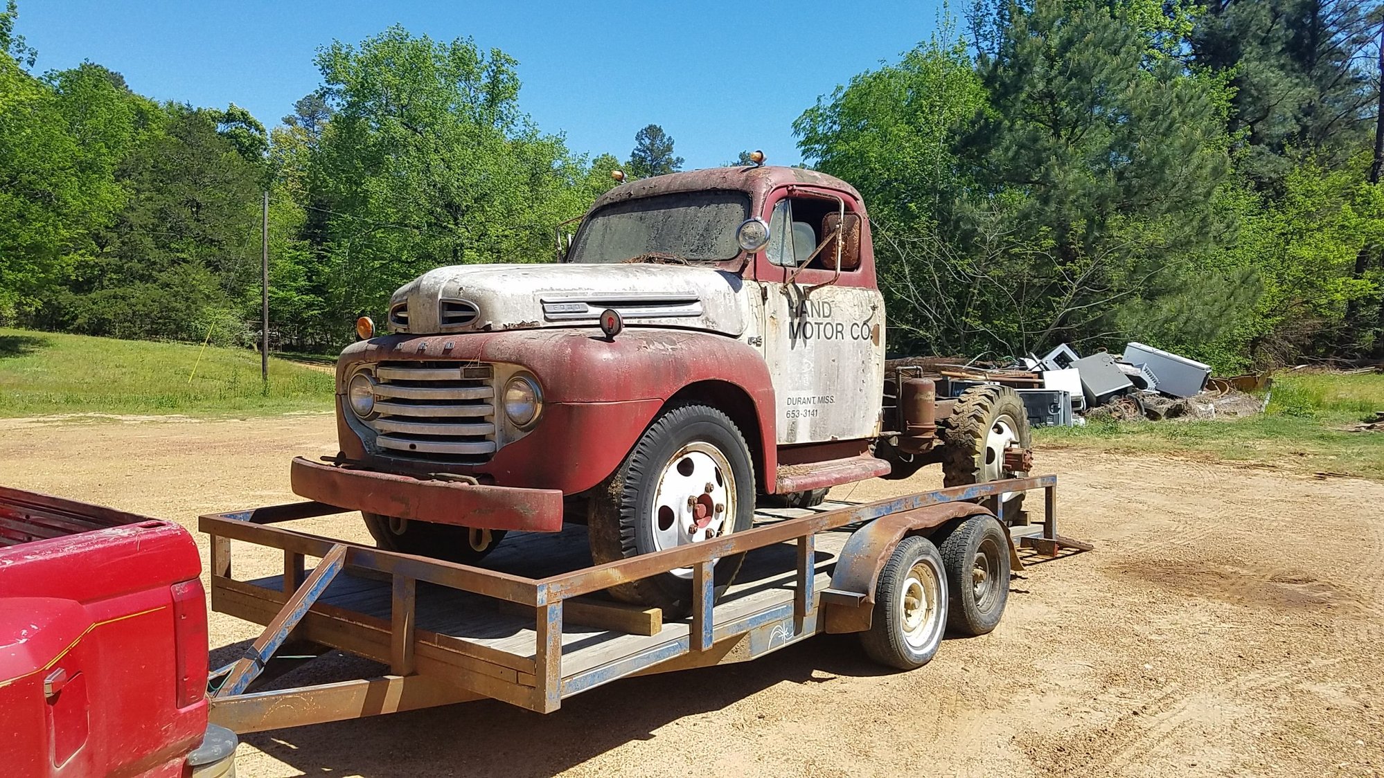

Finally after many months of life getting in the way I got her loaded up and brought home last weekend. The real fun is about to begin.

The wheels are 19.5 widow makers, am looking in my options to get them swapped out. Maybe the one piece 20" wheels, maybe adapters to use more modern Ford F350 wheels, just throwing around ideas in my head.
Am thinking lowering it and doing a patina hot rod look. This is a budget build so any advice welcome.
The Tulsa 19 L winch will go first, if anyone here wants it PM me a offer. Who knows maybe trade for something I need.

I don’t think you have 19.5s, which are tubeless. I’m seeing some widow maker 20” wheels, that should be replaced, and some locking side ring 20” wheels that are safe to keep in service if they are in good shape. I might have interest in your Tulsa 19, and have available locking side ring 20s with tires if you want to think about a swap. Stu

Your right rear dual is not a widow maker. So checking the others would be wise. You will find that a 19.5” set of wheels when fitted with 8R19.5” tires (the biggest that are correct for the wheels) will be about 4” shorter (or more) in diameter than your current wheels/tires. Road speed would be reduced. Stu

That is a good looking F5! Great to see another big truck here! It looks to have a 134" WB, a 9' bed would look right at home there.

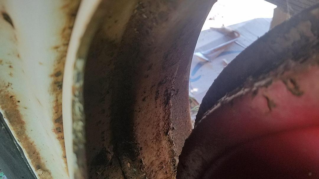

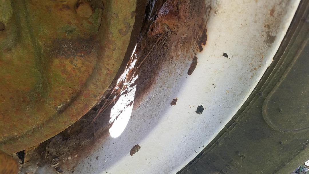

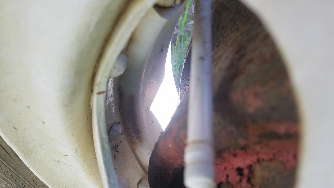

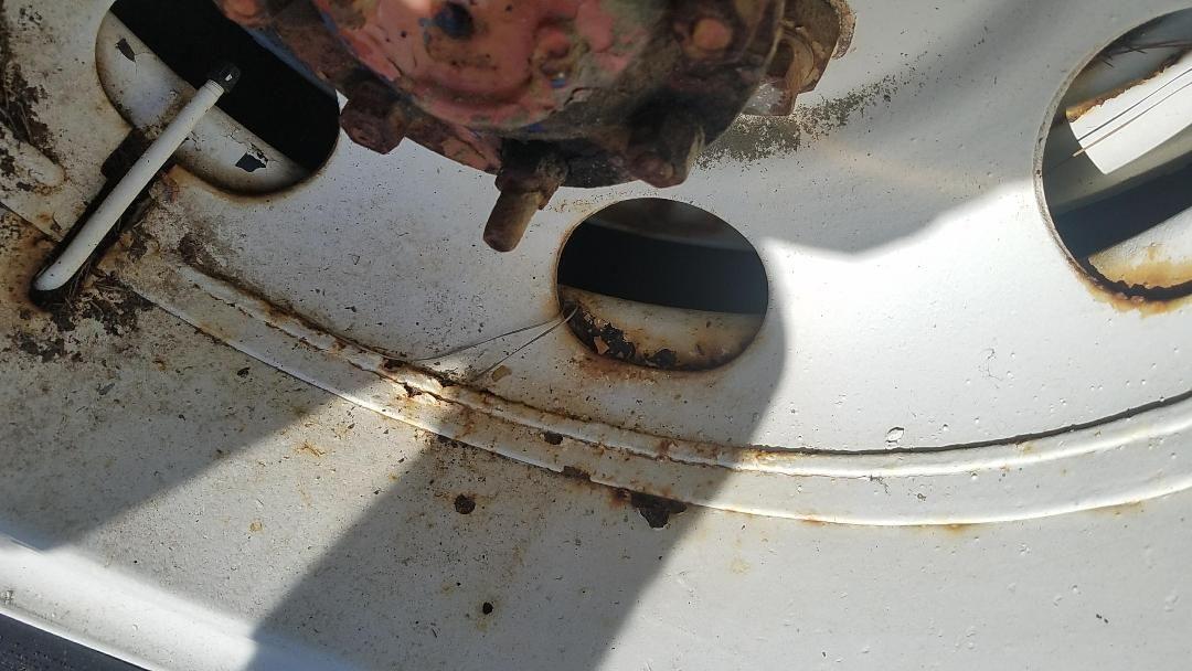

Wheel Questons....
So I am kind of confused on these wheels. Originally I thought all the wheels I had (only 5 wheels on this dually truck) were the same.
Now thanks to Stu (truckdog) I see the front two and the single wheel on the rear driver side are the same and have the locking ring that is about 1 1/2" wide that I believe indicates they are the widow makers. See pics of the rear driver and front driver wheels.
Old Apr 30, 2018 | 08:45 AM
ravenclaws's Avatar
ravenclaws
Joined: Jun 2017
Posts: 41
From: Sallis, MS
The rear passenger side wheels are the same and do not have the bolt heads or the 1 1/2" raised area. If you guys could take a look and give me advice much appreciated. I THINK at this point I have three widow makers and 2 'good' wheels. So I THINK at this point I am looking for 4 more 20" side lock wheels correct????

I believe I am seeing four widow makers (fronts and inner rears) and only one (the outer right rear) that is a locking side ring design. But I’m mostly going by your first group of pictures. The below pictures are some I’ve saved that show the joint around the middle of the rim. Hope these will help you compare yours to see whether the four are widow makers. Stu
