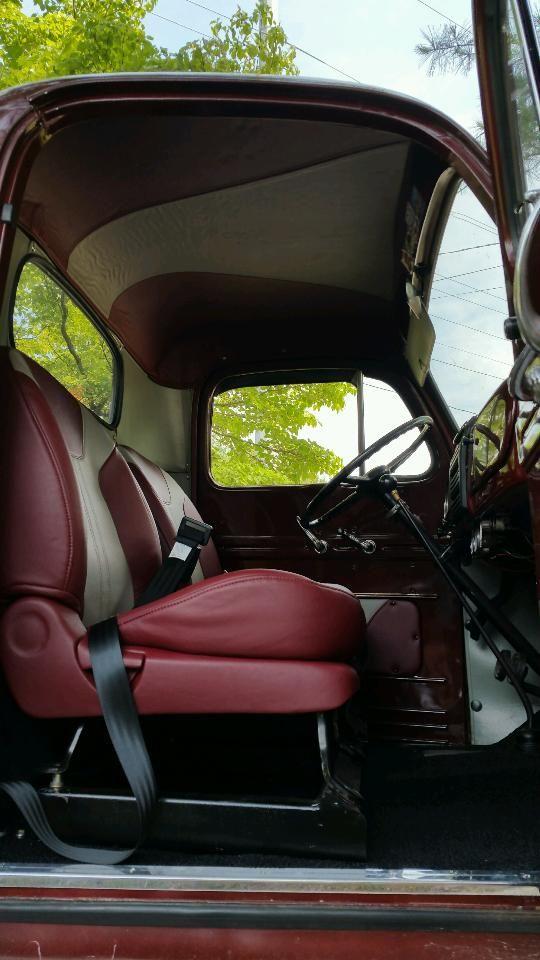

The interior panels for the 48 et al body are the cardboard units. I had the header panel covered in vinyl to match the seats and door panels.
