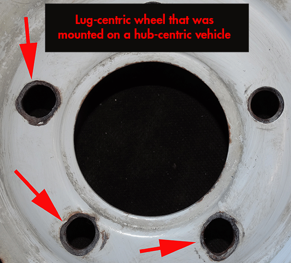

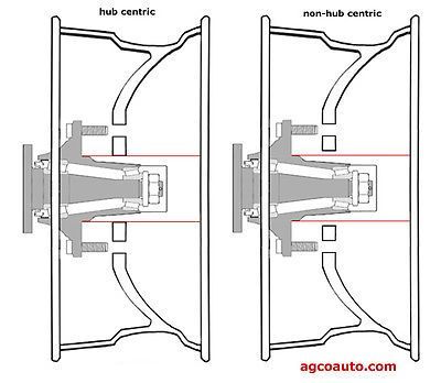

Might make sure they were made specifically for Ford applications. Fords are different from other brands in that their wheels are hub-centric instead of lug centric. That means Fords depend on the flare of the hub to keep the wheel centered and from wobbling. If you don't use a spacer with a flare, you will have problems later.
Here's a picture for you:
See the space between the wheel and the hub on the non-hub-centric image?

Originally Posted by Braggs
Might make sure they were made specifically for Ford applications. Fords are different from other brands in that their wheels are hub-centric instead of lug centric. That means Fords depend on the flare of the hub to keep the wheel centered and from wobbling. If you don't use a spacer with a flare, you will have problems later....
How true is that really? Modern hub-centric wheels use flat lug nuts that just clamp the wheel axially and do nothing to center the wheel. Older Fords use tapered lug nuts that fit in tapered holes in the wheel which seem to do a very good job of centering the wheel, just like all lug-centric applications. Yes the hub is also a tighter clearance, but that seems more like a belt-and-suspenders deal than saying that old Fords aren't lug-centric.
Anecdotally, when I bought my Bronco it had "Jeep" wheels which cleared the hubs by a lot. No idea how long they had been on there, but everything still looked good. And I had "Jeep" steel wheels on my '95 F-150 for close to 100K miles. The tapers in the wheels still looked good when I sold that.
I know that a couple of success stories don't mean it's not an issue. But saying that old Fords aren't lug-centric isn't completely true.
