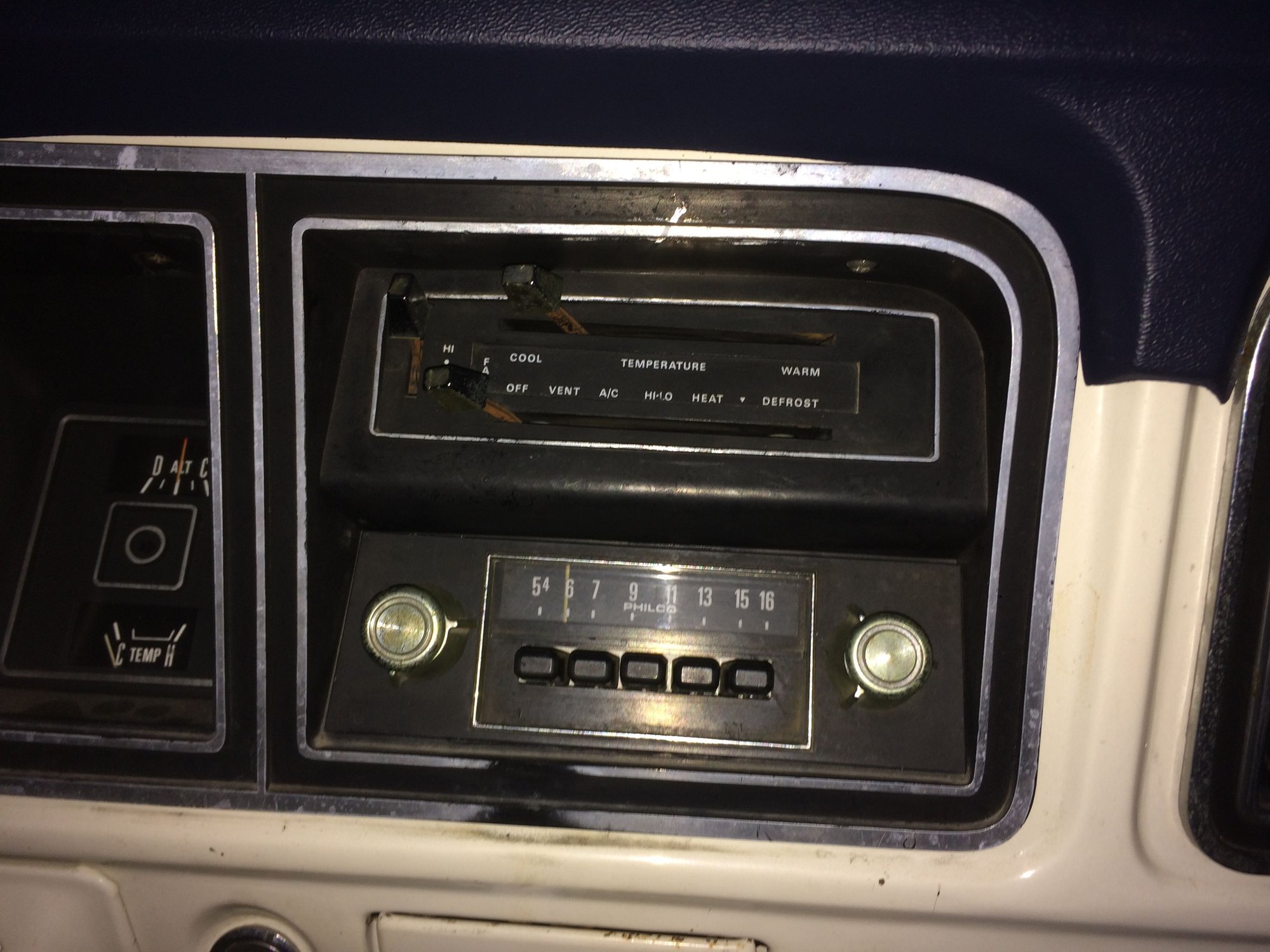

Does your truck have factory installed integral A/C (combined with the heater) or the Hi/Lo Comfort Vent System?
I have this:

Originally Posted by azul_grande
I have factory installed integral A/C
Factory installed integral A/C is combined with the heater. The A/C controls are in the same panel ^ as the heater controls.

OK, I have factory installed integral A/C.
