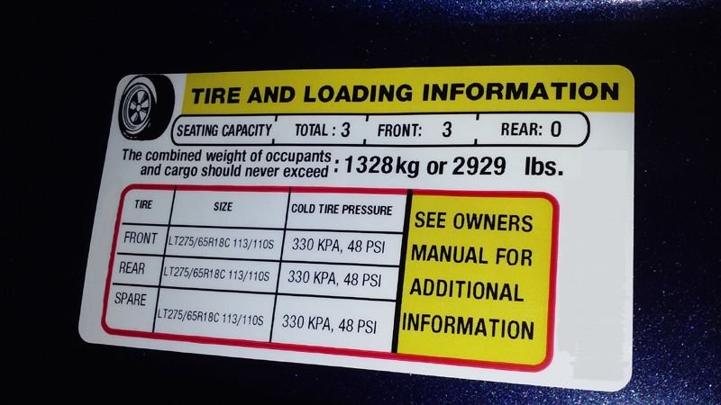

I just bought a 2017 last week with the Heavy Duty Payload and Trailer Tow packages. Reg cab 4x4, 5.0L, 18" wheels. Here is the payload sticker:
