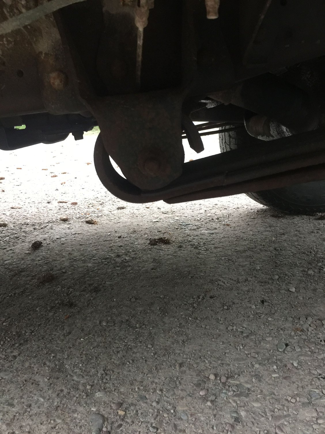

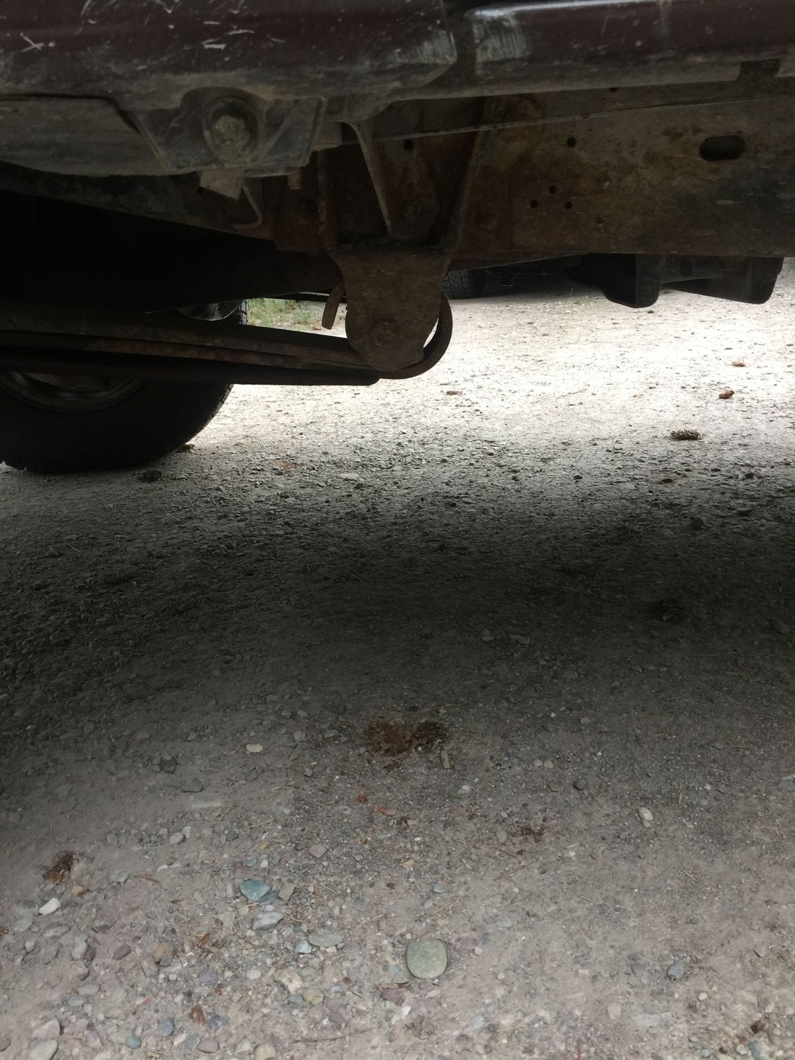

Was under my truck earlier and I got to looking at my front leaf springs. Snapped some pics. The rear of both springs don't look right to me. Why is there such a gap between the springs and the bushings? Worn out bushings or something else? No problems with steering or driving and rides good. Wish I had another truck around to see what it looks like. Can anyone clue me in on this?

I think you're looking at the wrapper leaf. That's the one that wraps around the main eye that has the bushings.

yup. as Junior said, you are looking at the second spring, not the main leaf that connects to the shackle.

Look fine to me, the bushing sppears to be present and pressed into the spring or it would be visibly sagging significantly. I believe you're referring to the military wrap on the second leaf. The purpose is if the main leaf breaks you do not have a catastrophic failure and can limp it home with the leaf just being sloppy around the bolt.

Okay thanks guys! Appreciate the info. Glad it's nothing to worry about.
