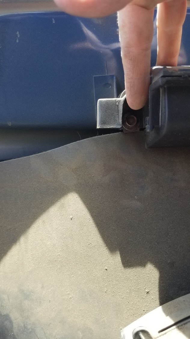

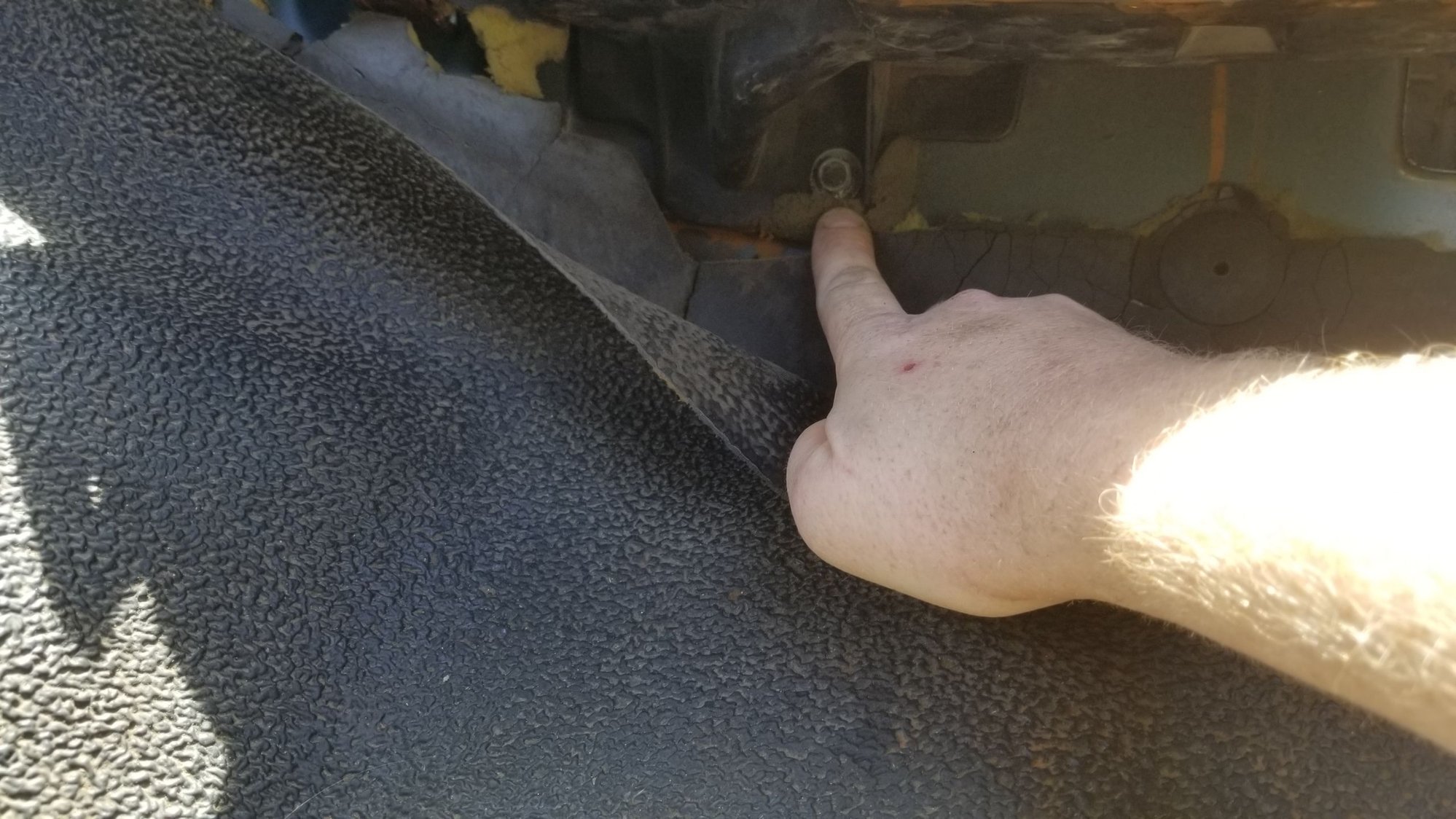

I'm deep cleaning my truck (nasty!), and trying tp figure out why I'm getting minimal airflow (i mean you can't feel it but hear the fan blowing).
I only see 2 bolts holding this thing on, do I need to dig deeper?

Look in the engine compartment, there are about 4-6 more

Take the inside passenger fender out. That will help in finding the bolts/nuts and gives access to the PITA bolts on the left side(looking twards firewall) firewall holding the inside airbox in place.
Here's a thread with photos:https://www.ford-trucks.com/forums/1...e-build-4.html
