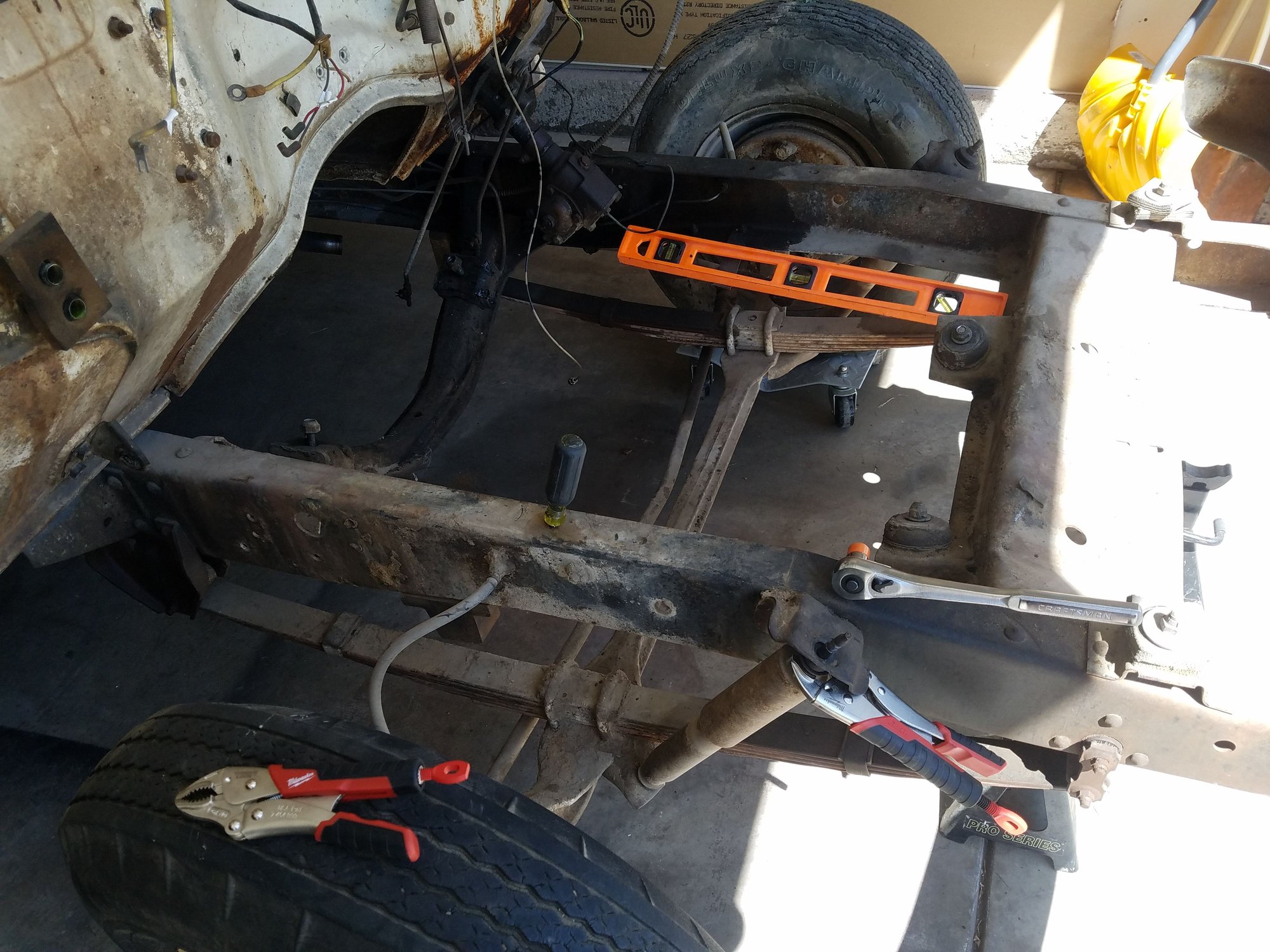

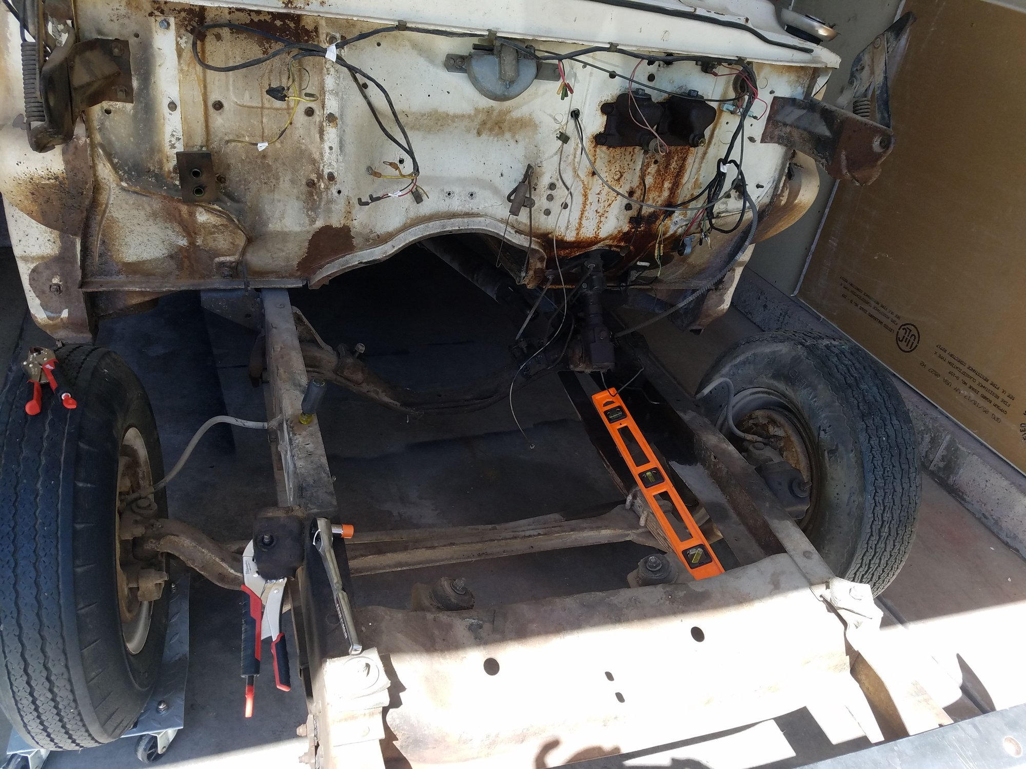

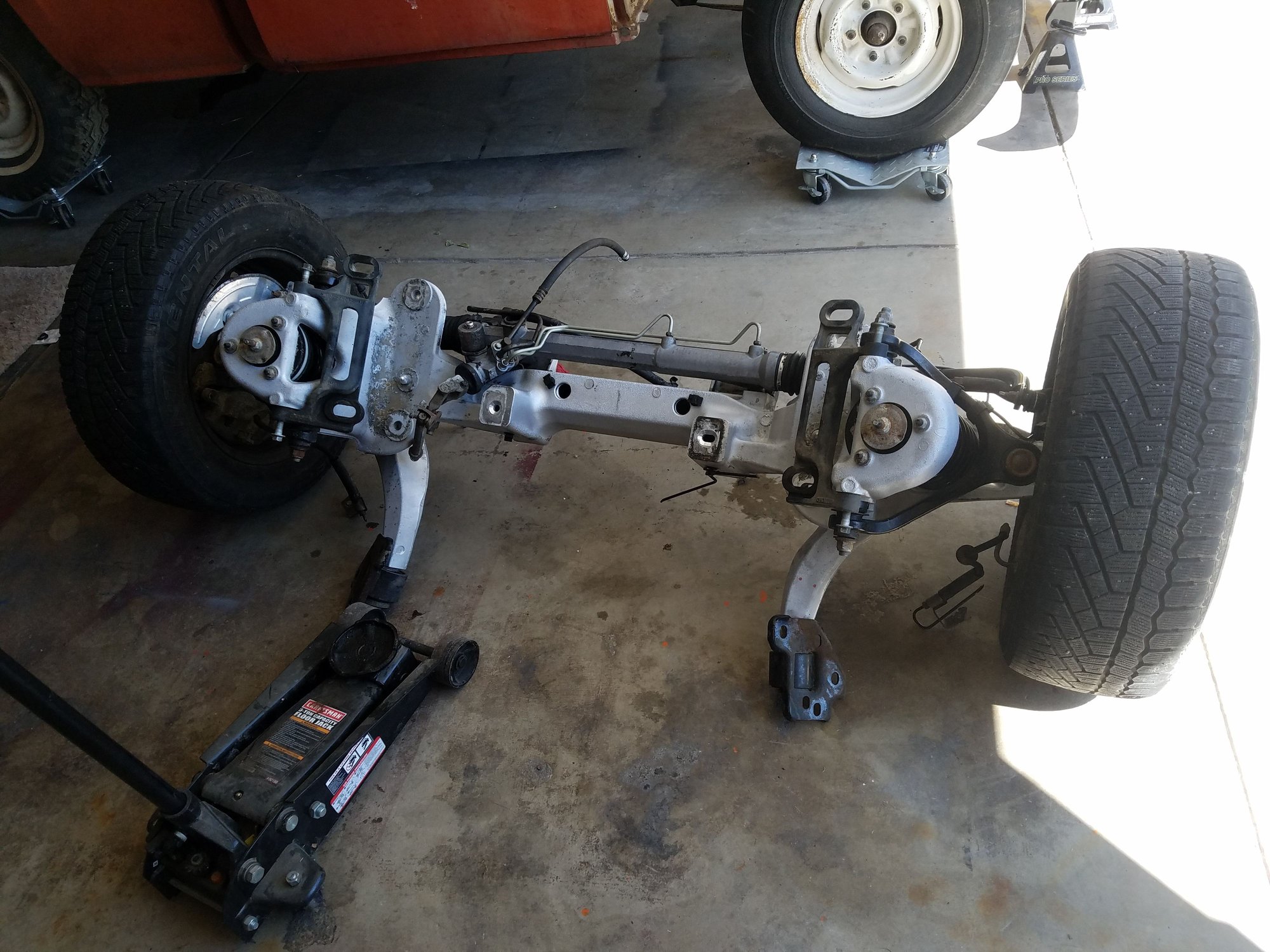

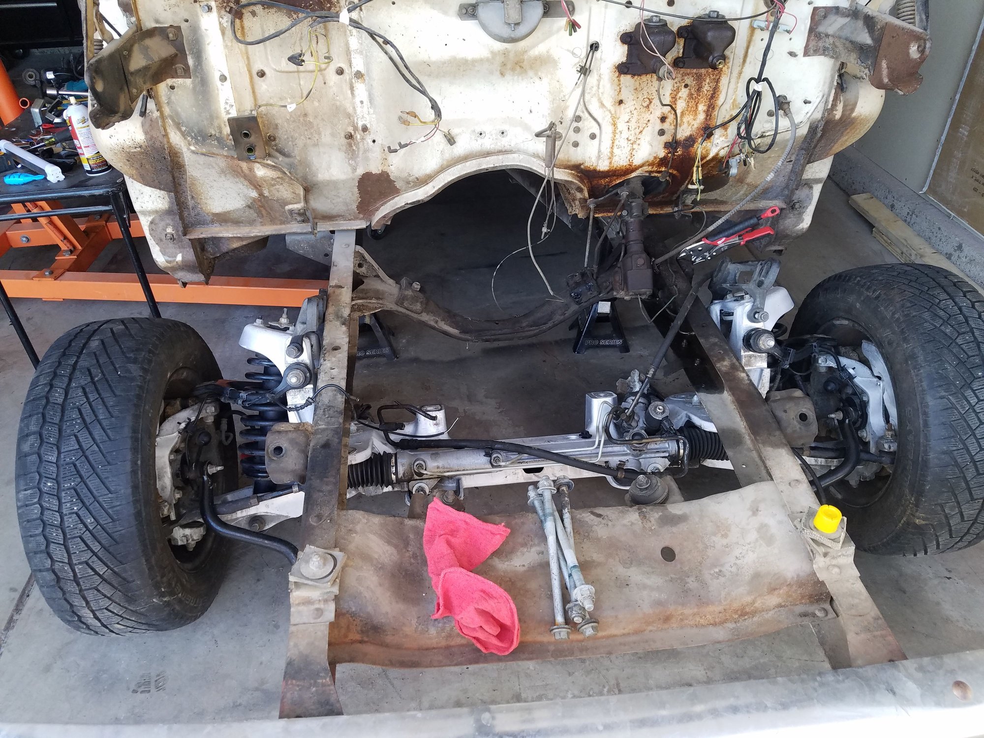

Finally getting started. It was a tough winter, so I am behind (like most). Just purchased my CV front clip and am getting started on installing it. Removed the old from axle last night and hope to have the new one installed this weekend. I was able to remove the old axle without cutting anything out, so I will be parting with original axle and 223 with trans if anyone is interested. I also have a spare tire mount I'll be letting go of as well.
took the front end off as one piece, it only took about 12 bolts to get it off, I've seen others install the CV front while leaving the front fenders on. I would not recommend that or recommend taking it apart in small pieces
I plan on dropping a 302 in it, still looking for transmission ideas, with a t-5 from an older Broncos work without too much fuss?
finally getting started!
