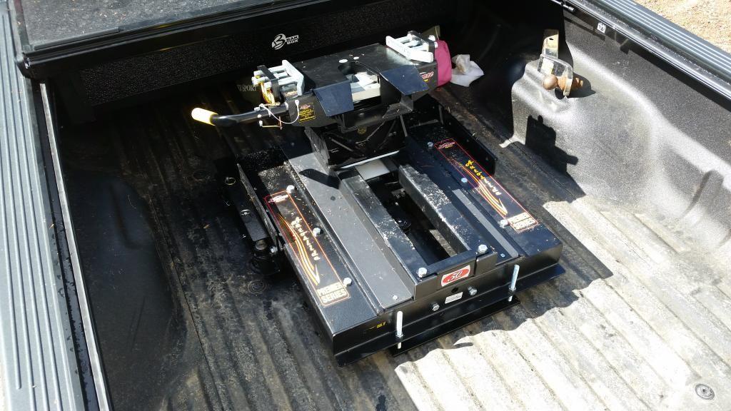

I have a Demco slider that uses the puck system. Have had it for 3 years and works very well.
http://www.dyersonline.com/demco-ums...-hijacker.html
For under $1,050 shipped.. it is a really nice auto slider. Uses the pick system as I stated and nothing needs to be done under the bed. Drop it in, turn 4 bars to lock in place and away you go. When I remove it, I hook up my camper, loosen the 4 bars by turning 90 degrees and lift the camper up which then lifts the hitch out of the bed.
Another nice thing about the Demco is that you do not need a capture plate like you do with the Pullrite. The hitch is all you need to go.

hey cool idea on using the camper to lift it out of the bed, do you then just let it hang from the camper til next time you need it?

Exactly. I take a strap and hook it to the rear of the hitch and then to the rear of the king pin and ratchet till it is tight. Otherwise it sits at a 45 degree angle with the rear down and top up as you try to lift it out. It won't clear the tailgate because the rear drags in the bed as you drive away.
But keeping it level makes for easy in and out.
