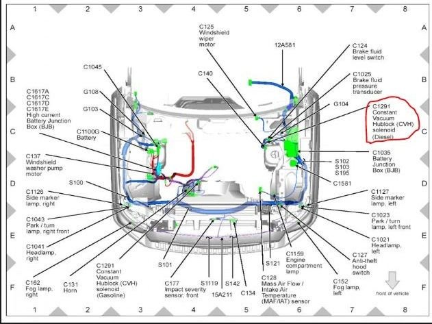

Manually locking the hubs works. In my opinion I have a vacuum issue, or a vacuum valve relay issue. Just need to find the location of the vacuum valve and start trouble shooting.

thanks thomabb, gives me a little better starting point than the hubs.

That did the trick. I had some work done by Ford a few months back, fixing an oil leak around the injector rail on the drivers side. I found the hub vacuum solenoid connector locking mechanism had been broke off and the connector not all the way seated. Once I hooked the solenoid back up, I immediately could hear a hissing sound of leaking vacuum. Inside the protective wrapping on the upper vacuum line coming off the solenoid I found a snapped vacuum line. Fixed the broke line, and all is good with auto hubs once again. Thanks to all for input and to thomabb for the schematic.
