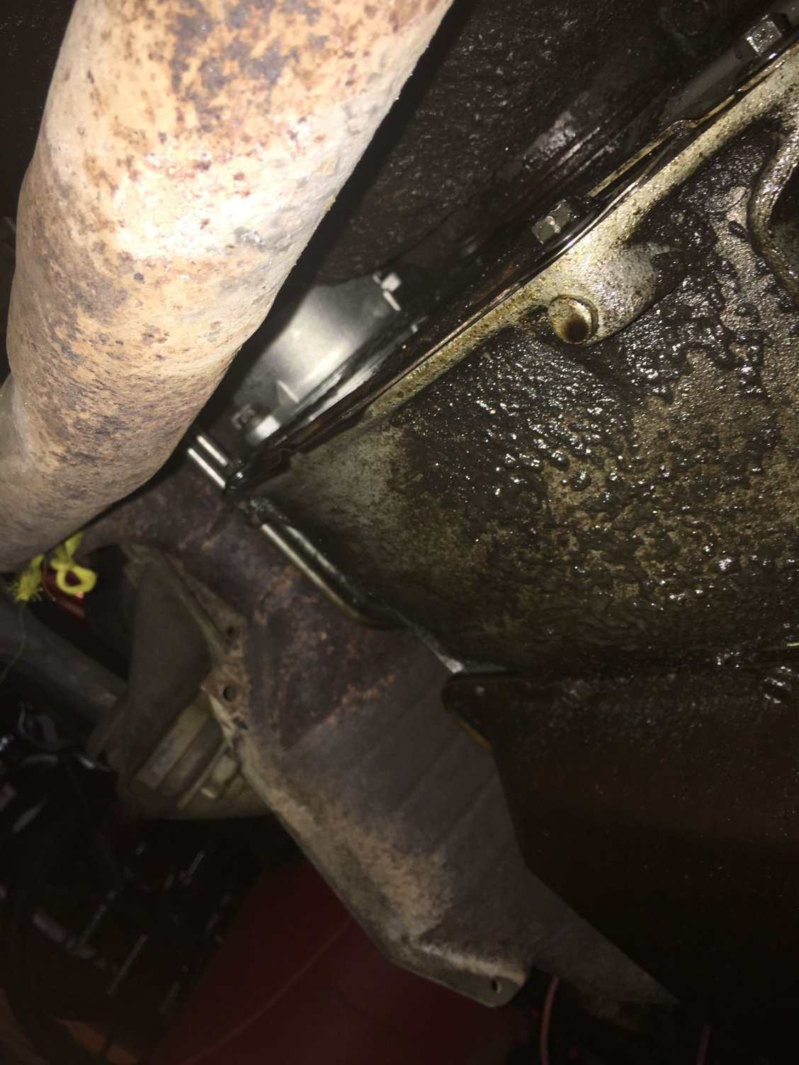

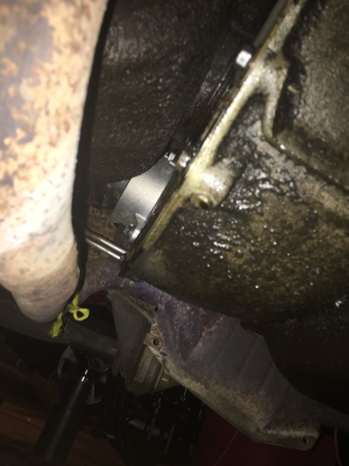

Hey guys I have a 1984 ford f-150 with a 302 2wd
Cant seem to find anything about how difficult it is to replace the oil pan gasket anyone do one?
Walk-through?
How hard is it? Does the motor needs to be lifted?

How about distinguishing the whether it's a oil pan leak or the read main seal?
