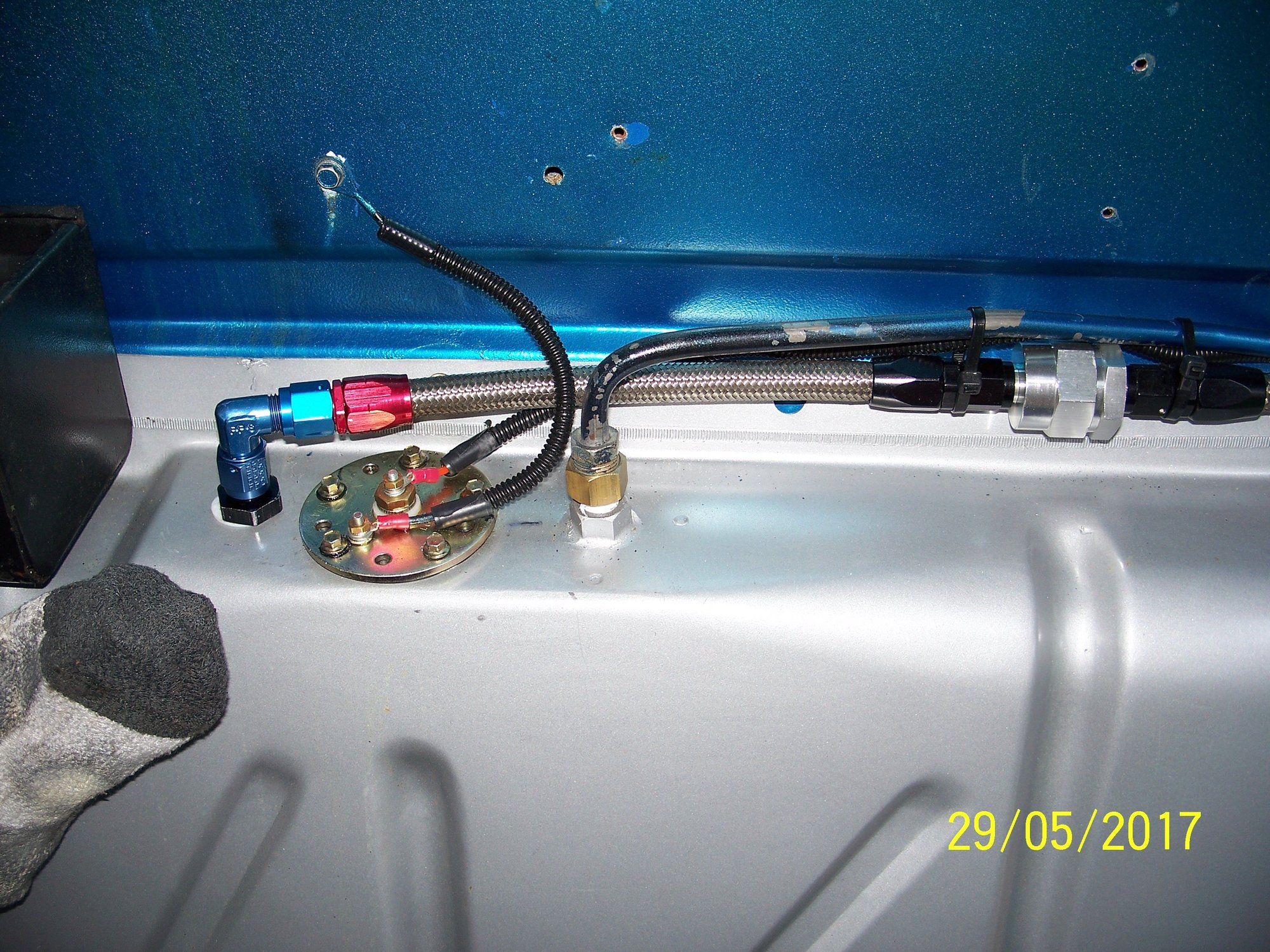

I've since hooked up the return SS brained line with a one way valve one it.
Their is new Holley fuel pump with a build in return line that can be mounted a short ways from the tank that, I thought about using but I wanted a double fuel pump.
Orich
The tank fitting, I tapped the inside an threaded a thick wall 12'' brass tube then screwed it into the underside of the tank fitting then reinstalled the return line.
