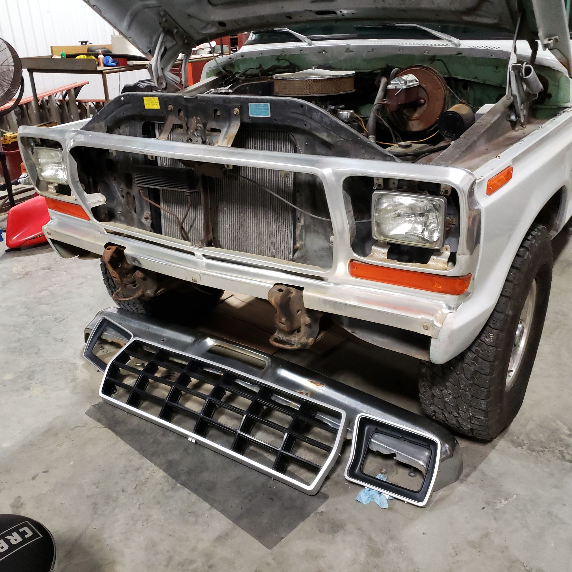

My back is now fused and I am mostly back in service. I actually got to spend about an hour this eve and start working on the front end. I got the front bumper off and got the headlight bezels (made in Taiwan) and the grill insert (made in Taiwan) taken off. I have to have the bumper straightened and rechromed. I have two holes to weld up first, i guess the PO put on some lights or something that are no longer there.
Have to see if I can find some original inserts.

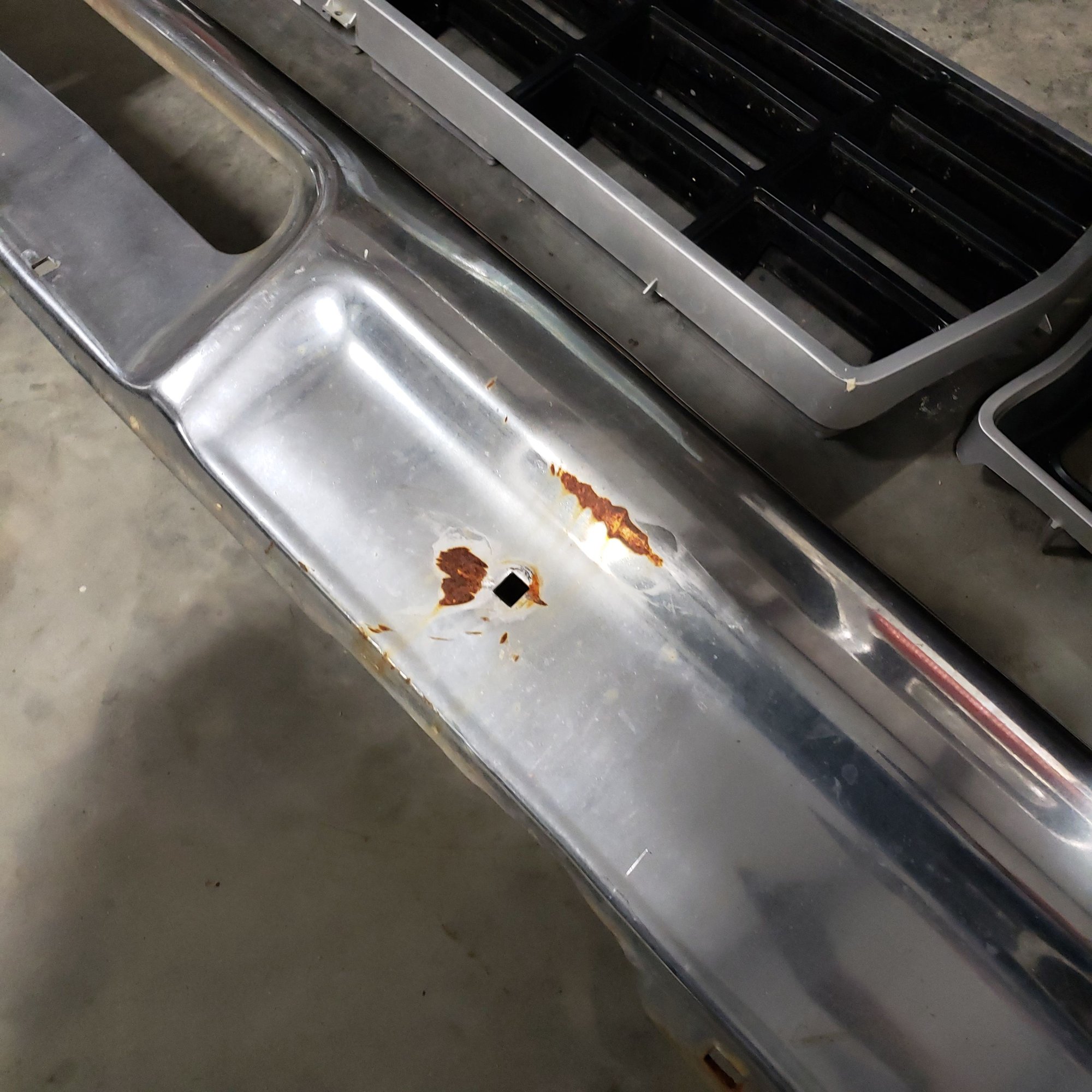

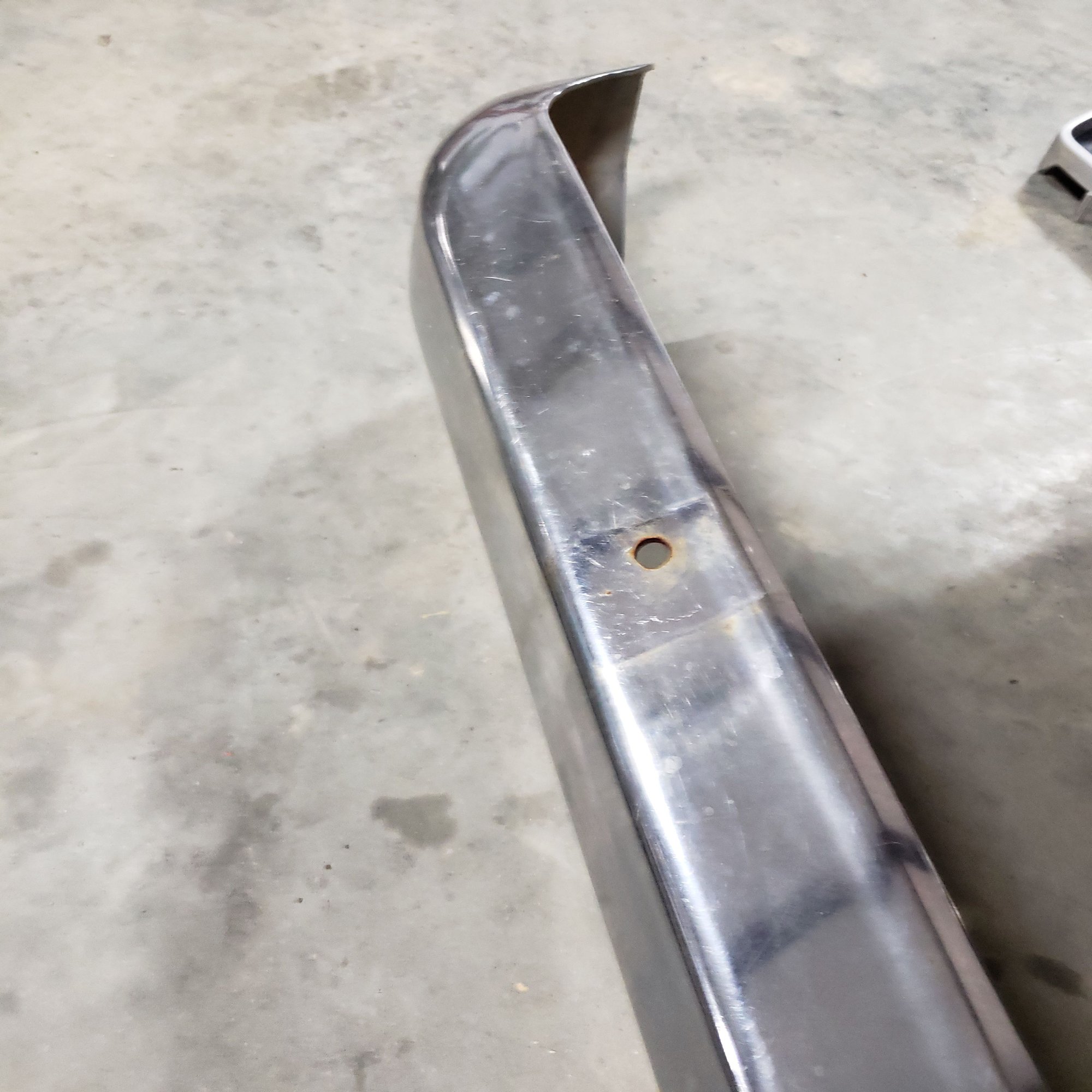

PO must have gotten carried away grinding off mounting bolts. Not too deep, i'll probably just smooth out and chrome over.
One hole on each side I'll weld up before having bumper straightened and rechromed.
