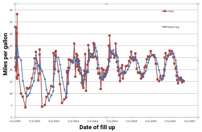

Here's my mileage for almost the last ten years. Every single gallon of gas that I've bought is here.
The reddish brown line is the actual mileage per tank, the blue line is an average of the last four tanks. The 4-tank averages tends to even out my over-fills and under-fills. I live in Alaska, so it is easy to see that as the weather cools off and I am using 4 wheel drive more and doing warm ups, mileage drops. Prior to 2011, I lived in a town where my house was about 1 mile to where I worked, so the truck never really warmed up in the winter and so mileage was really bad. Now I am about 10 miles to where I work and the truck gets to warm up on my daily trips. Curiously, my best mileage occurred shortly after I got the truck before I upgraded the early 1999 air filter to the current AIS filter and housing. These best miles occurred in 2008 on long summer business trips in the interior of Alaska where I would drive from Glenallen to Anchorage on a single tank at 55mph to see what optimum highway mpg would be. I had four trips that year where I got between 20 and 23 mpg. In future years I was never able to consistently get better than 18mpg on identical trips.
