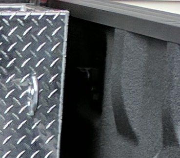

I used the forward 2 cleats to secure my truck box. I used a Oak wood block between the cleat and the box for spacing. I used Lag bolts from the cleat into the block.

lkbrow1, I can't follow your response, are you saying the block is between the cleat and the boxlink brace? or the cleat is insert in the boxlink brace and you have the block bolted to the cleat?

The oak block is between the toolbox and the boxlink cleat in the gap shown. Block not in picture.
