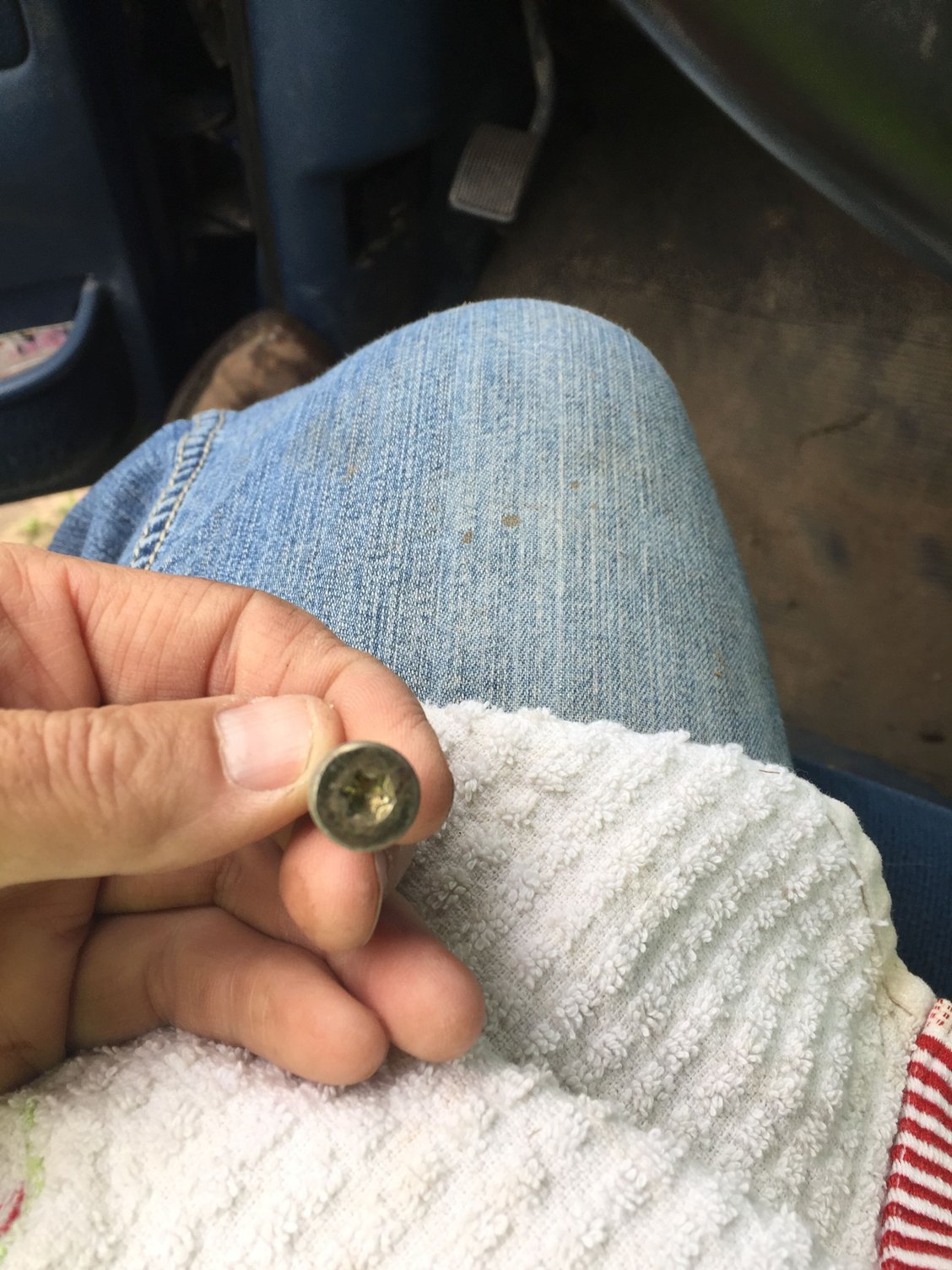

E brake bracket doesn't appear to be loose. He said the part that majority of electronic goes through, its notorious to going out after getting wet from windshield leaking which my truck does, he took down the last 5 numbers of my vin and A/ to be able to get the part. . I reached out to him yet again today and get no answer so apparently I have lost the money I paid for the part as well as the part.
My dome light still comes on I have not tried to start it as the keys were pulled. Will I wreck more thigs if I start and drive it to town?
I did find this today small screw/bolt and he may have taken it out but I never asked where from under the dash.
