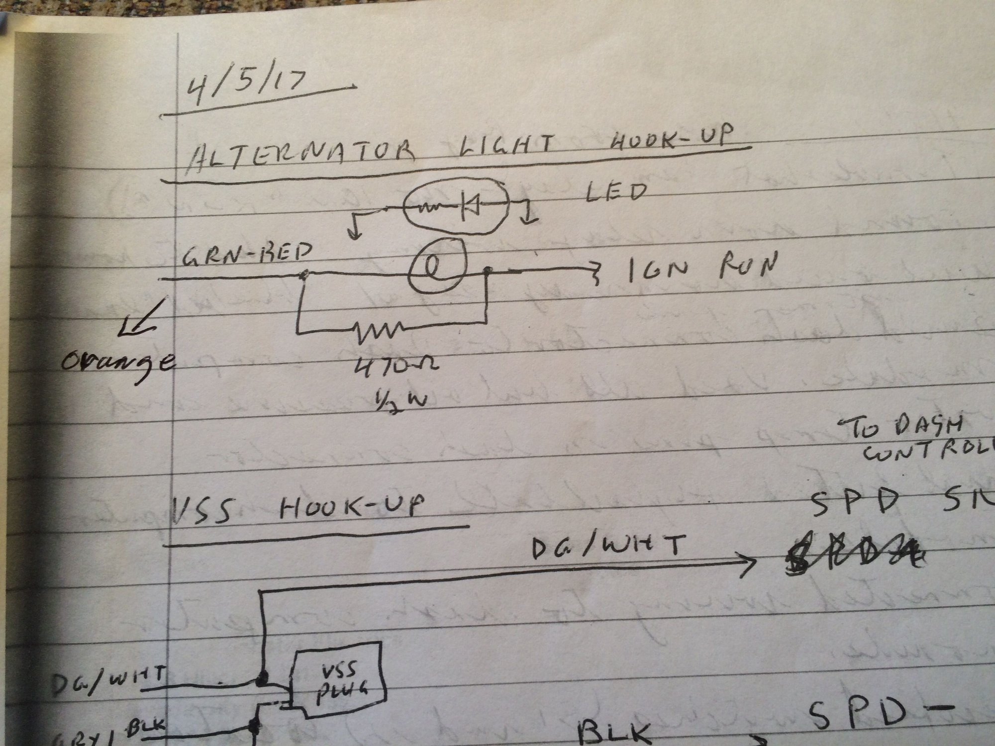

Originally Posted by tip49
Not sure what year your 302 is but my '90 5.0L has a wire from the alternator that used to run back to the instrument panel, and idiot light. I think the wire is green with red tracer or red with green tracer. ( I would have to confirm that.) The incandescant light bulb was parallel connected to the wire with the gauge and then ground. I currently do not have it connected, but do have a wiring diagram for my donor.
My engine is out of an 89 e250 so wiring nearly the same
Chuck made up a plan
