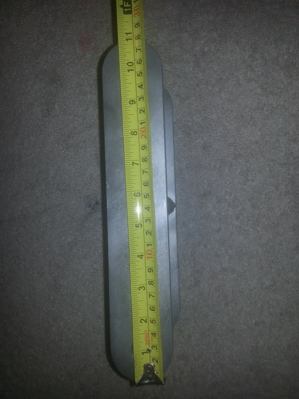

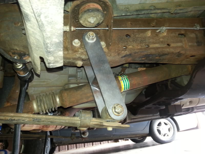

How long is the factory front axle shackle? I'm looking to incorporate them into my current '86 F-250 Dana 60 setup, but don't have any of my old notes.
The shackle pictured is a 2" lift shackle that is 11" long. Was installed on my old 2002 X. That makes me think the OEM shackle is 9".

Stock is 5". You're going to want to measure from center of hole to center of hole.
