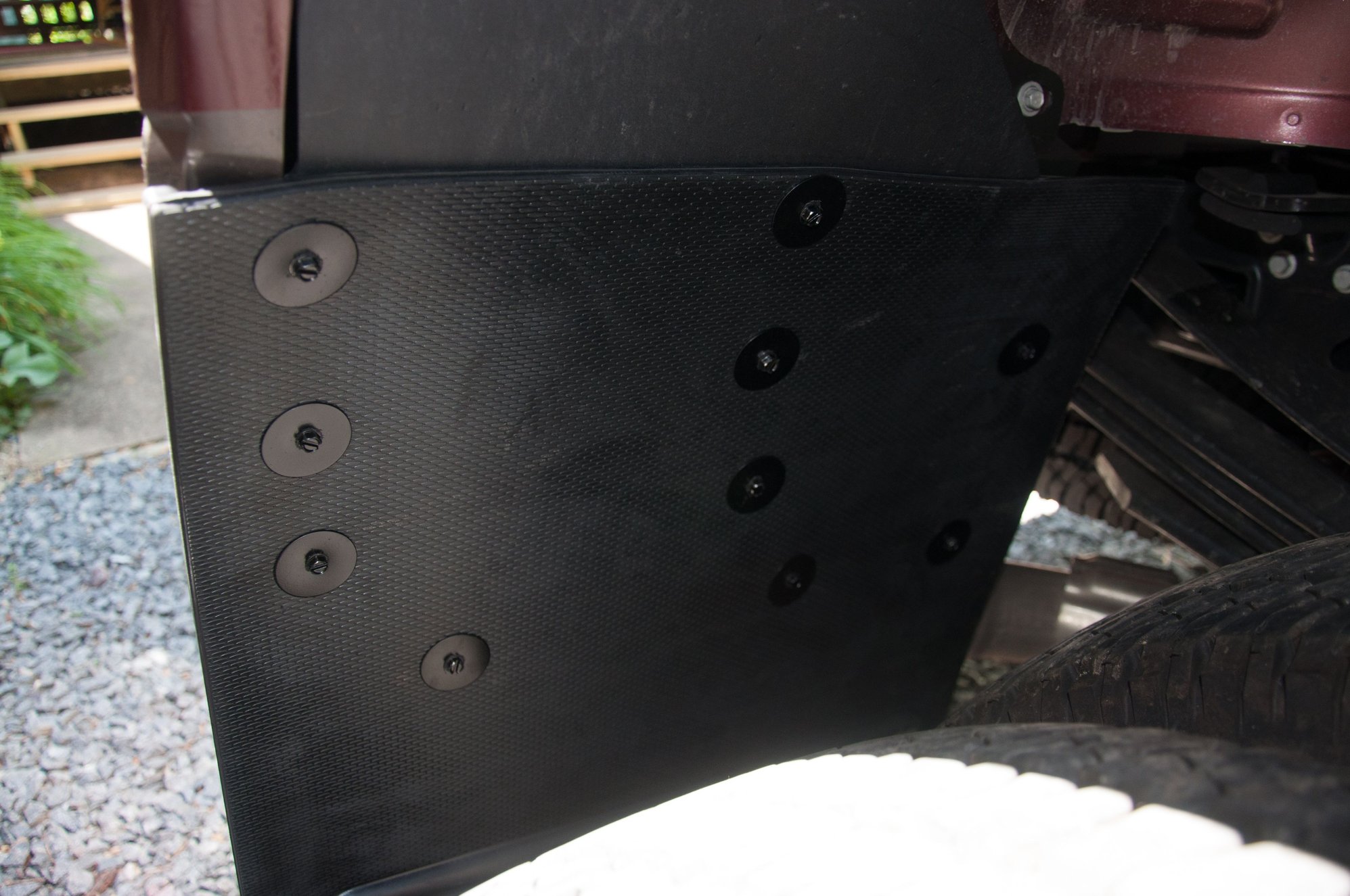

I just installed mine yesterday after painting the brackets with rustoleum self-etching primer and then satin black paint. The aluminum is bare so I just did a little bit of sanding then cleaned it off with mineral spirits. I put a few minor scratches on the hardware during installation, they don't show. I also painted the hardware that shows in the wheel well, I didn't like the look of the stainless against the black rubber (see the pictures).
