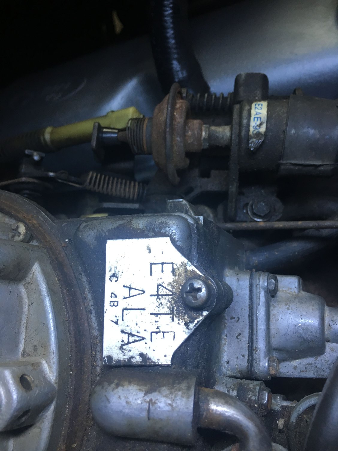

Hey guys I have a 1984 Ford 302 with a Original Motorcraft 2 barrel on it it I finally got it running after 20 years of sitting it seems like it bogs down when given gas I was going to start with a rebuild of the carb unless anyone has suggestions
It has an ID plate that says
E4TE
ALA
C 4b 7
Im trying to figure out which carb I have an which rebuild kit I need for it And can anyone recommend where to buy one?
It has an ID tag: E4TE-ALA
E4TZ-9510-AL .. 2V Carburetor ~ ID tag # E4TE-ALA (Motorcraft CA-3287) / Obsolete
E3PZ-9A586-T .. 2V Carburetor Kit (Motorcraft CT-1471) / Obsolete ~ 19 available NOS

After 20 years, a rebuild would be in order. Rebuilt carbs are available from National Carb in Florida also. Mine was relatively cheap at 170.00 w/o a core.
