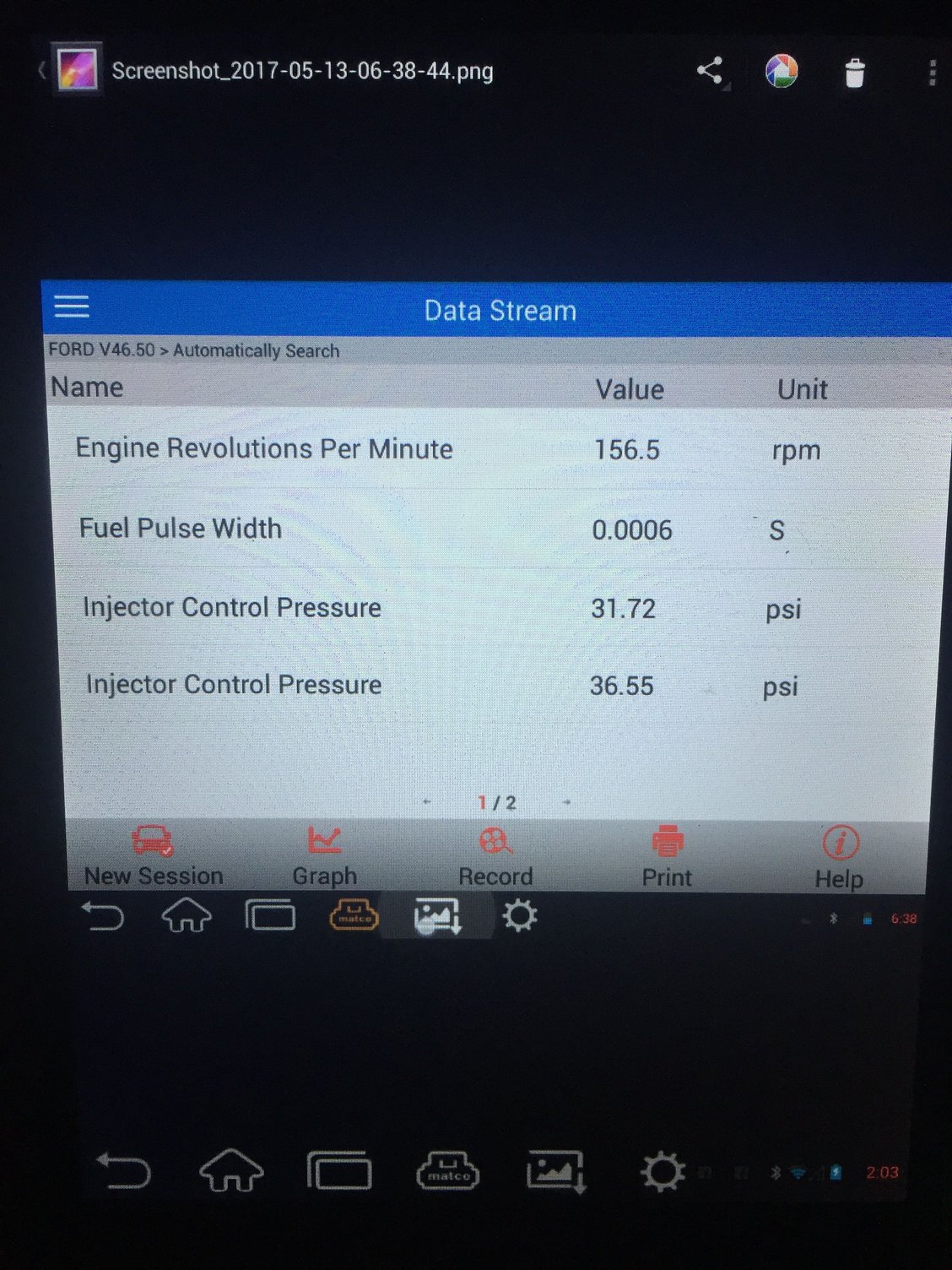

Alright guys took me a little longer than I expected. Here's what I have after my hpop change, rpm 156 fuel PW 6 MS ICP 31 psi (way low) ipr BW 14.8% icp .22V, I dead headed the pump and I'm getting nothing on my mechanical gauge. Am I looking at a junk pump off the shelf? Bad ipr? Need some help here. Injector buzz test was good no codes, not a pcm or idm problem.

Yes, the IPR% should increase if everything else is good. Are you sure the PW is 6 MS? It should be 0.6 MS waiting for ICP to climb to 500 PSI or higher then go to 1-6 MS. Try unplugging the ICP and see if any of the parameters change.

here's what my computer gave me hussler, I'll try unplugging the icp here in a bit, I just woke up, gotta love working nights lol

Yes, that's .6 milliseconds, that's good. It means the PCM is detecting CPS and the PCM and IDM are in lock (talking with each other).
.006 would be 6 milliseconds.
So for some reason the PCM is waiting for HP oil to ramp up but it's not, so ... It's puzzling why the IPR% isn't even trying. If it's not the PCM is waiting for some other parameter to kick start everything.
