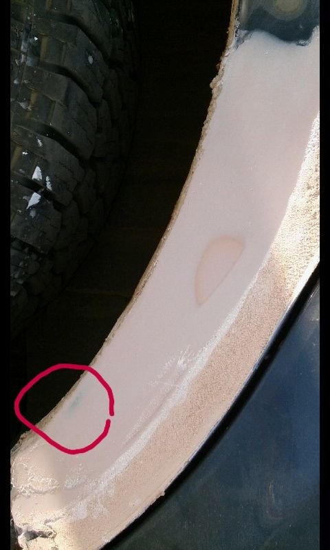

As promised, slow progress. I'm still working on the fender rust repair. This is the second coat of filler nearly sanded out half way. I've got a high spot in the mesh and kitty hair I'm trying to blend into, but it is giving me grief. I keep finding the high spot first before I've got the rest blended into it. I'm still trying to restore the fender line but I can't sand over the high spot to get it sanded out and shaped.
Bottom line is that i really dont know what im doing and im learning as i go. I think I'm going to have to settle for less than perfect.
Can you see the problem area?
Offending high spot
Wide angle with the trim off so I can sand into the bodyline.
Slow going....

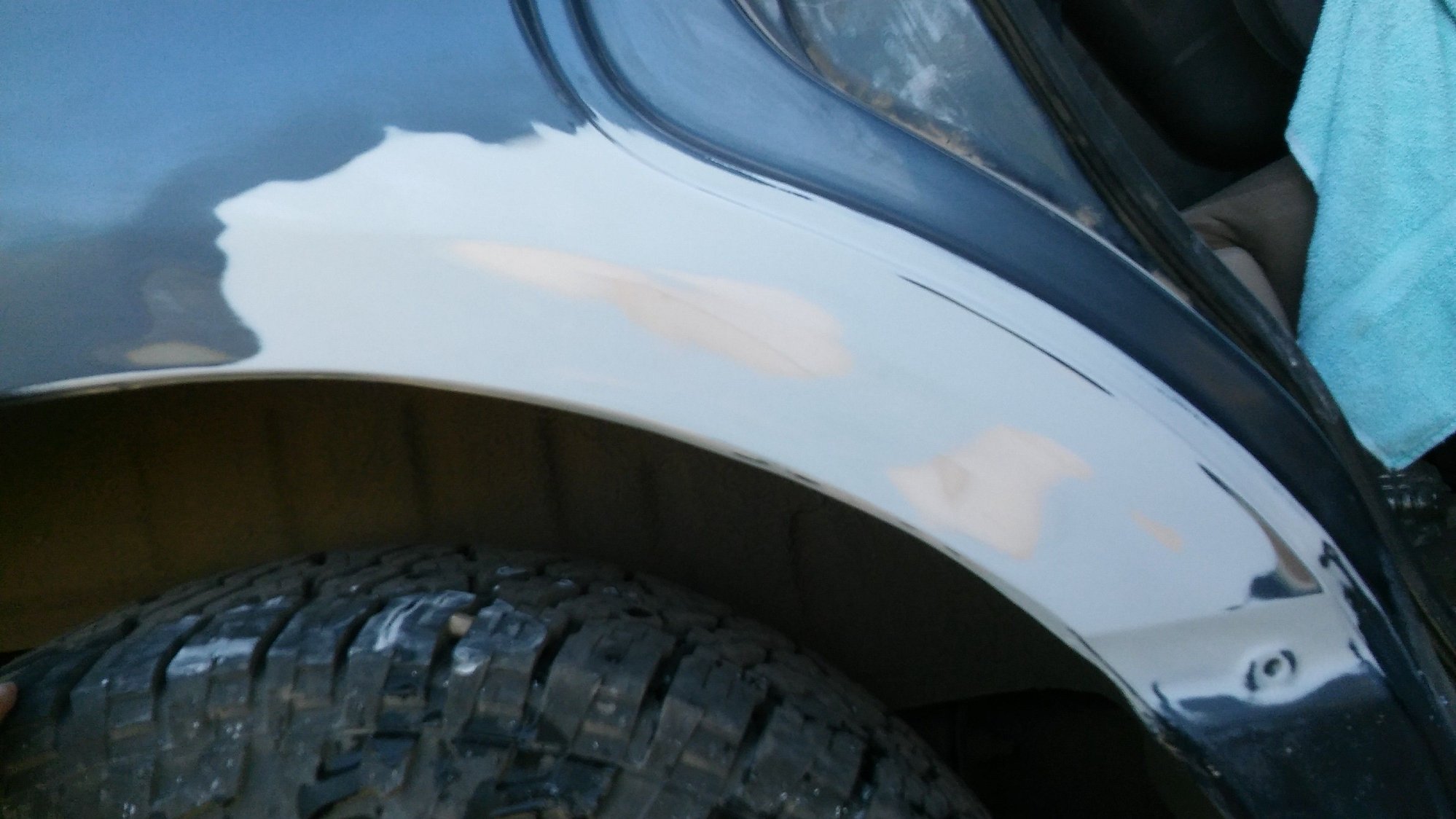

Got a little farther this weekend. I've just about hit the "good enough for government work" stage. It is pretty well flattened out and the bodyline is almost right. It looked better before the primer, but thats what it is all about - each stage makes it just a bit better than before.
If you look close at the picture with the primer you can see my body line is a tad too high as it comes into the filler and it is a bit too "sharp" so I need to change the angle on the top and bring the body line down about 1/16" or so, then round it all off so it isn't so angular.
This is the high build primer before any sanding, so you can still see some of the rough spots in the filler, but the primer should flatten it out pretty nicely.
So this is 1 very rough coat of kittiy hair, then another smooth coat of the same, with two coats of regular filler on top of that. Then two coats of high build primer. Which sounds like a lot of filler, but you end up sanding most of that out.
The wheel lip is the roughest part. It is ok, but not perfect. Looks better from the face than it does from the bottom, and I'm ok with that.

Little bit more progress tonight. Got the first coat of high build sanded down and put another three coats on last night. Got those sanded down and all the imperfections in the filler leveled out.
Unfortunately, I'm still not happy with the body line. It is still too high and still too sharp. Of course you cant see these things until it is all in primer and you get some low angle light on it.
It's pretty flat on the face, so if I can sand down the filler on top to lower the body line I should be done at that. Then it is just trying to match the curve of the body line as best as I can. If you look close, you can see where I lost the body line at the bottom. Ot kinda takes a Wrong turn where it goes into the trim piece. Not sure if I can fix that or not. We will see when I get the bodyline on top straightened out.
The high build primer left more porous spots that need to be filed. I used a primer that is thicker than the sealer but thinner than the high build and put on a sloppy wet cost of primer to fill the micro bubbles. There's runs and drips bit it doesn't matter because ill end up sanding almost all of it off anyway when I block sand It.
Slow going, but it is getting close.
Had some help
There's some promise here
High build sanded flat and ready for regular primer
Sloppy wet coat of a scratch filling primer.
Not quite right. Close, but need to do some more shaping
I'm learning more and more that body work is more about sanding and knowing when to quit than it is anything else. Spraying color is relatively easy, but the shaping is where the real art and skill is at.

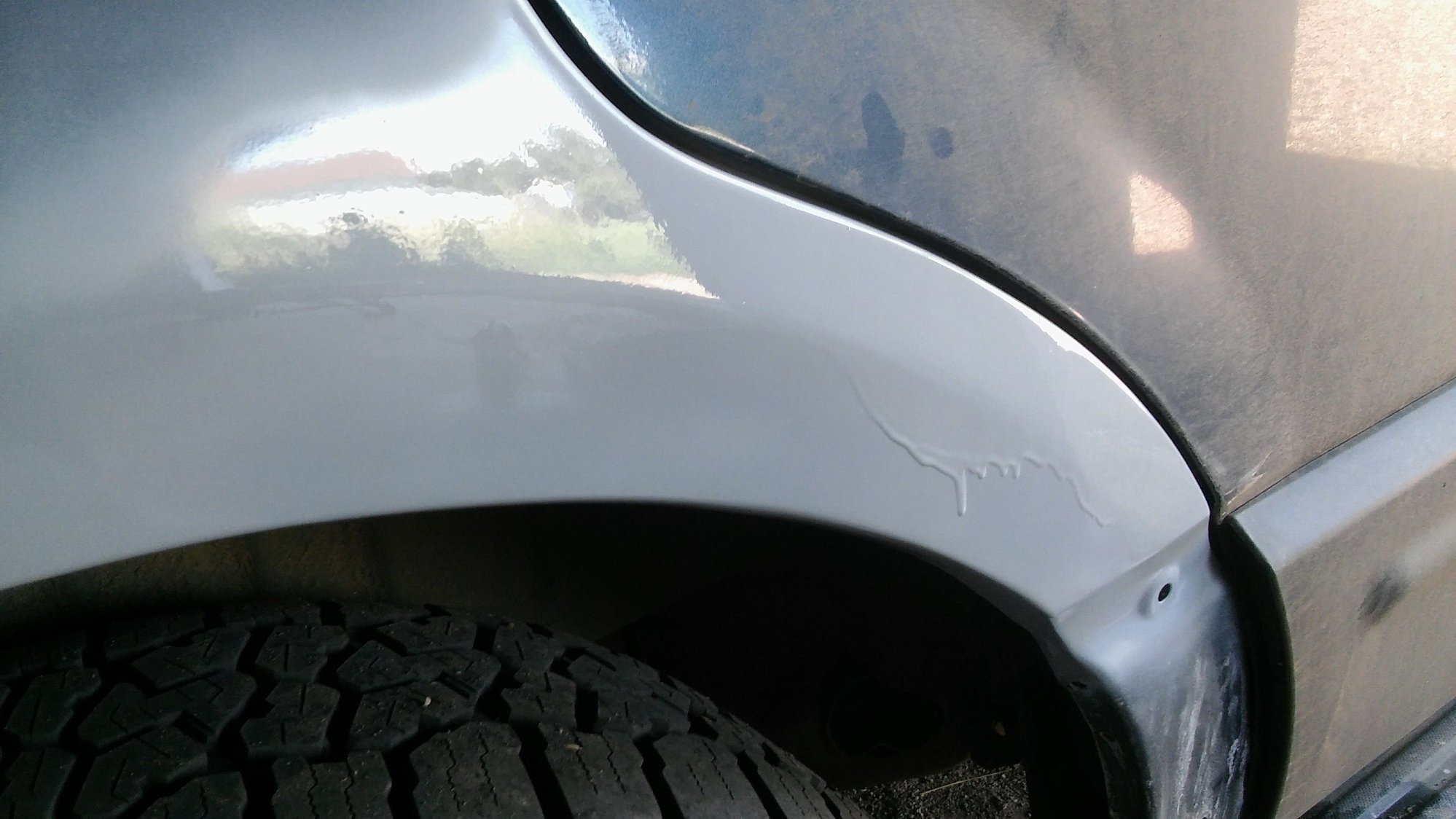

Kids went down for a nap so I worked on it real quick today. The primer I used filled in some of those micro bubbles, but either not all of them or it left some of its own.
Getting these all filled in is getting old.
Left with another runny mess to sand down.
Yes, Virginia, spot putty would be the best way to fill those, but I still don't have any. And this works, I guess.
Was hoping to spray bomb it blue with the cheap stuff so i can see how the contours look, but thats not going to happen today.
It looks like my primer can barfed on my truck
I warned you this was going to be a slow project.

Sanded everything flat down to the primer this morning and resprayed it with sealer then color bombed it with my color match rattle can to check the body line.
I think I'm done shaping except for the inner wheel well. Need to hit that with the dremmel sander again so the edge of the lip is straight again. All jn all not too bad for a guy who doesn't really know what he's doing.
Sanded flat.
Those holes still didn't fill in.
This is the high spot. You can see the clear kitty hair and wire mesh behind it. Good time to stop sanding.
This corner is high as well. Again, a good time to stop sanding. A little more high build here would level it out but it is probably flatter than when ford built it.
It's blue!
Body line seems to match ok and seems pretty straight so I'm calling it done with the filling and shaping.
Inner wheel lip. Need to straighten the edge back out. Not that anyone but me would notice.
Got carried away....
So the plan from here is to sand all this color off with some 600 grit and spray it with the good stuff. Hopefully later this week.
Honestly, I could just be done here. But this rattle can stuff doesn't hold up very well and it will always stand out. And i've got the good stuff so might as well use it.

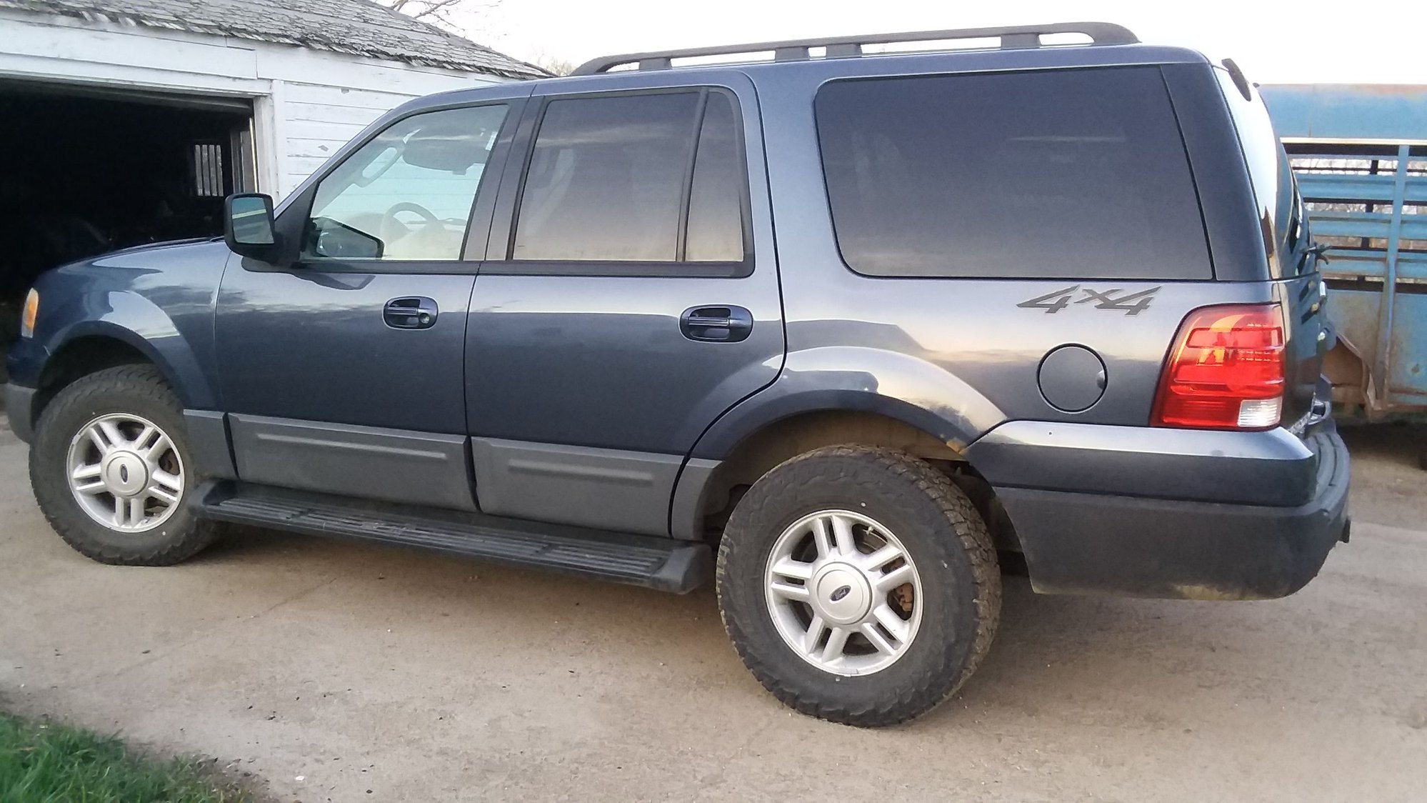

The equipment i used to do this was about as basic as you could get. I've got a cheap 11 gallon compressor which goes through a cheap regulator. I used a cheap disposable filter/dryer in front of my clearance HVLP touch-up gun i bought on clearance at Tractor Supply. I was able to get decent enough spray pattern and it looked pretty good. The rest was done with just a long thin sanding block and regular wet/dry sand paper.
i've got one bubble on the tailgate in a corner that i painted. i'm not sure if i didn't take enough out when i did it, or if it started outside of my repair and worked in. but everything else i touched is still holding up really well. there is a nasty spot up by the brake light that may or may not have been there when i did the rest. if it was there i didn't notice, but it's pretty ugly now.
the fenders both have some rust under the paint now. i think i just left them exposed to the elements too long and trapped moisture between the metal and paint. primer absorbs moisture pretty easily when exposed to the elements. in hindsight, i should have blasted those areas with a heat gun before painting to drive the moisture out of the primer. A word to the wise, if you are going to do this like i did and take all summer doing it, put a top coat on it at the end of every night. any cheap rattle can paint would do, so long as it is covered to keep the primer from absorbing moisture. i may or may not redo the fenders this summer. its got 215,000 miles on it now, so i'm starting to care less and less how it looks
all in all, it cleans up really well, but it is usually pretty dirty.
i'm glad i did it.
