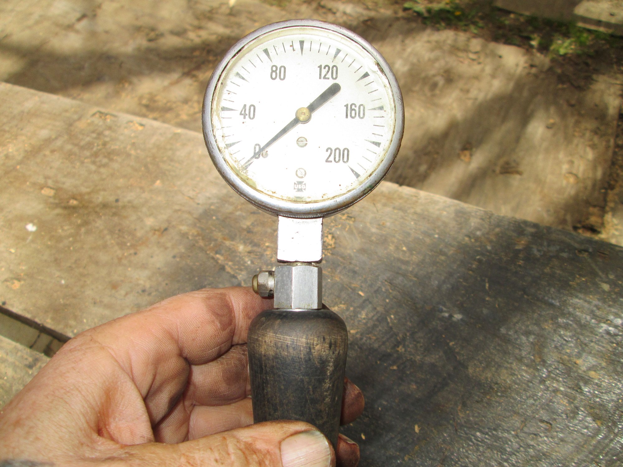

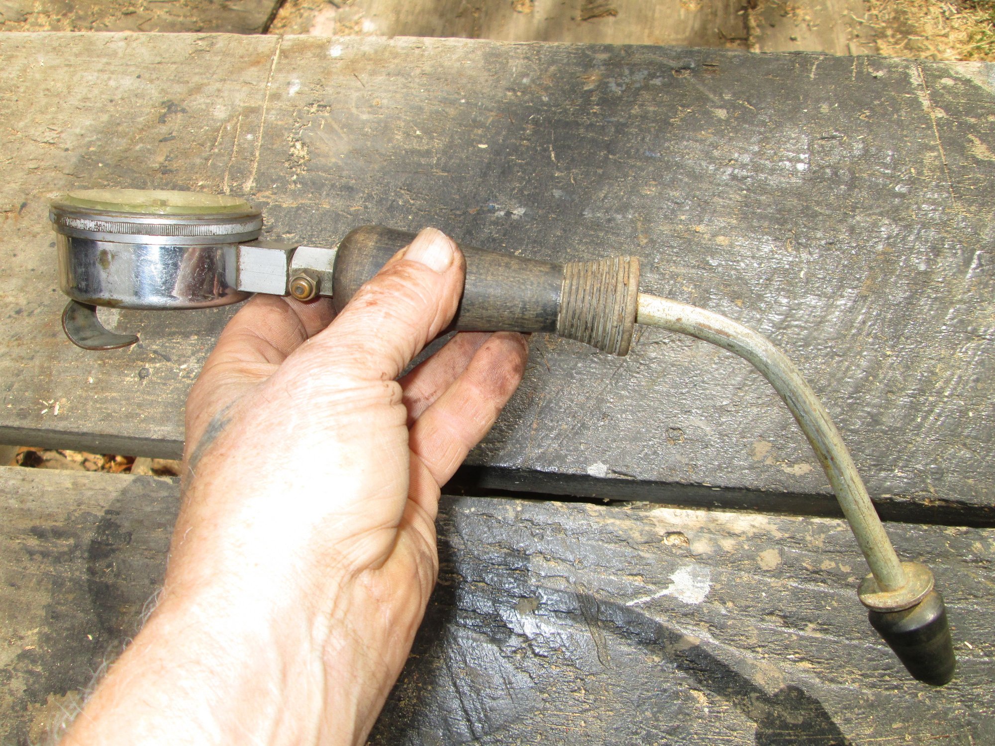

Houston Dave and Fuzzybob: Ever see..or use.. one of these before?

Sorry for the double pictures....

mine has a screw-in connector for the spark plug hole...
